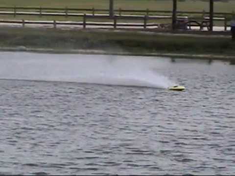

        well Bill shot some video of the sniper today.
        Still working out a few kinks - wants to hook in the center of the corner, but running strong

          That's EXACTLY what my 47" did for the longest!!! I made a whole thread about spinning out. I have since gone to a longer setback rudder brace, the largest blade I could get that is not tapered, and a 300oz servo. Not as bad now but it still digs in at times.
          The crazy thing is.............that Bill has the same hull as I do and his doesnt do it, he has no secret setup, I have asked about his Cog etc..............glad his works so well.

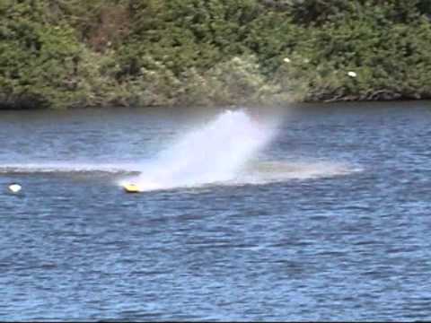

                        I trimmed the rudder and rounded it, relaxed the starboard trim tab and WHAALA...she turns real nice. Thanks for the tip Jaike5.
                        I loosened it up too much with the stinger height adjustment I'm gonna take 1* back out of it. I'm thrilled with the handling of the boat now, even though I did manage to flat spin the boat in the vid Bill got Sunday... just like a giant DF33, running this sucker is a blast
