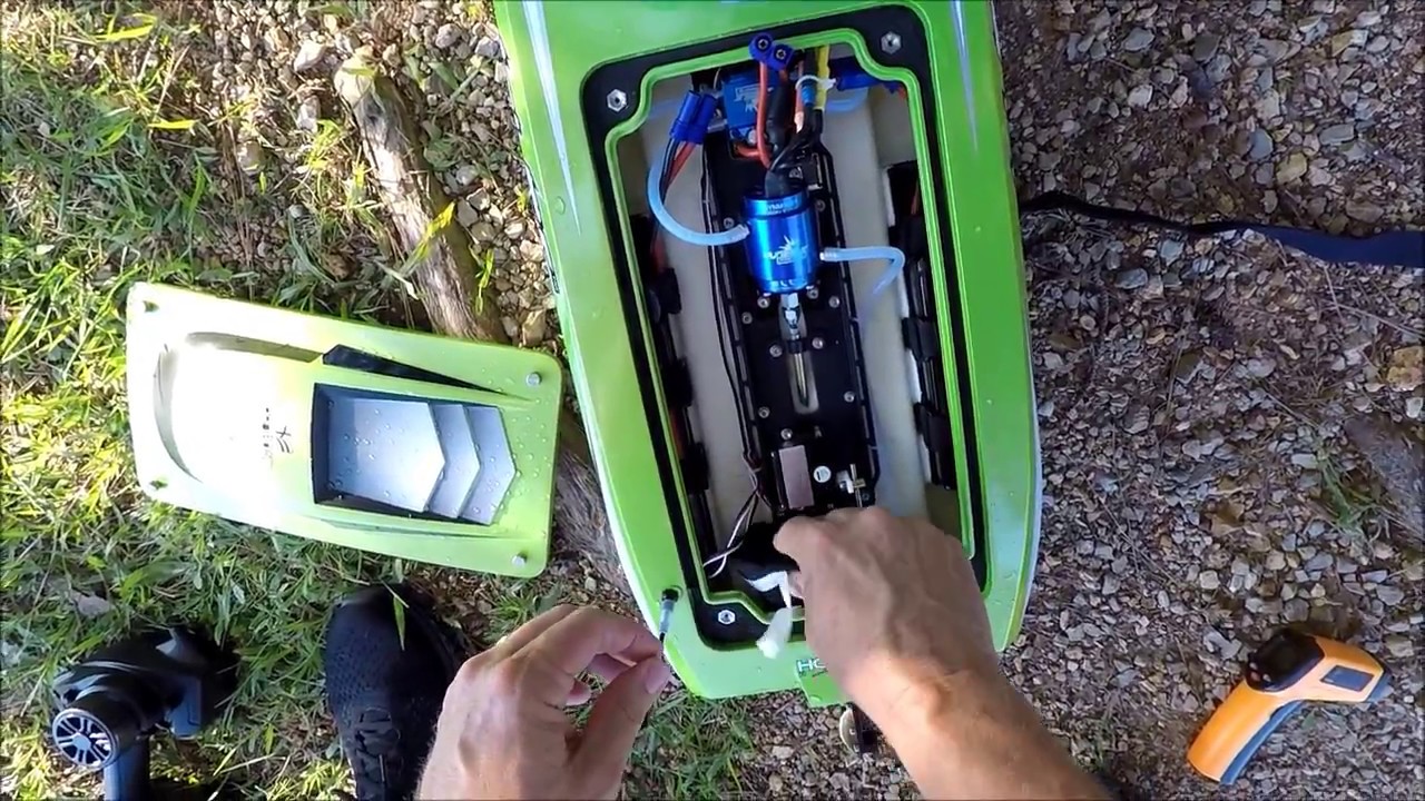

Mod number one will be floatation similar to what the Zelos has for the canopy just incase....Here is a photo of the sponsons if anyone is interested. I'm very impressed with the build quality of the hull also! Rafael you have outdone yourself on this one! We now have a mini Zelos!

I also made some good use of some of the packing foam, I put a couple of pieces that were already cut perfectly in the front of the bow. They were like they were made for this area. Only the one large block in the center was there from the factory.
