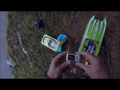

    Here is the 70mph run. The boat still needs a little tweaking.The temps are higher than normal because this run was right after my initial all stock 60mph run and the rain was about to start back, so I couldn't wait as long as I would like to have before going back out. "warranty is up"!!! (as Chris says). I got to thank him again as well....Thanks to Chris for the Awesome Prop that helped me get in the 70+mph club again with another stock boat.
    [ATTACH=CONFIG]153778[/ATTACH]
    Wow, that's way more than I ever expected to see from this boat in stock form. Honestly, my focus when I designed the hull was on creating a boat that would handle corners and speed and be 100% different than the V3 29" hull. I was never too interested in top speed capable with the stock system. Good job!!
