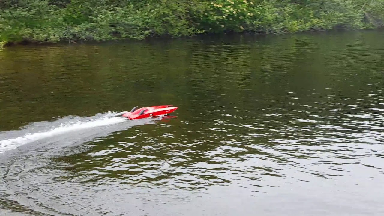

                            #343
                            Old thread but i figured i could update you all, and ask for advice. The boat are finished and the maiden voyage somewhat worked great except that the rudder servo burned. Which lead me to my question, what kind of servo do you guys suggest i use for the rudder. The one i had was rated at 6.4 kg and apparently it was not strong enough for the task.
                            Picture IMG_0666.jpg And a of the boat, maiden voyage
                            • Jesse J
                              scale FE enthusiast
                              • Aug 2008
                              • 7241
                              #344
                              Hey Frankie, glad to see you stuck with it!
                              Looking good, but I would try to loosen her up a little; kinda wet running.
                              What angle do you have the strut?
                              Where is your center of gravity?
                              How much above your sponsons is the center of prop shaft?
                              Are you giving your servo more voltage than it is rated for?

                                #345
                                Thanks Jesse :) Sadly English isn't my native language so i have no idea what you mean by "loosen her up a little".... also are you talking about the rudder when ask about the strut? Center of gravity i assume you mean the pivot point of the boat, that's at 57 cm from the front (total length of the boat including the rudder are 101 cm)
                                "How much above your sponsons is the center of prop shaft?" I assume you talk about below the hull when i have it lying upside down, which would be 2,5 cm
                                Servo are 6v (aka not the new 7,4V) and that's what the ESC are giving, i'm thinking more along the ideas that i need a stronger servo... a dealer here talked about one that are rated 25 - 35 kg (which really sound like overkill to me, but i'm a newbee).
