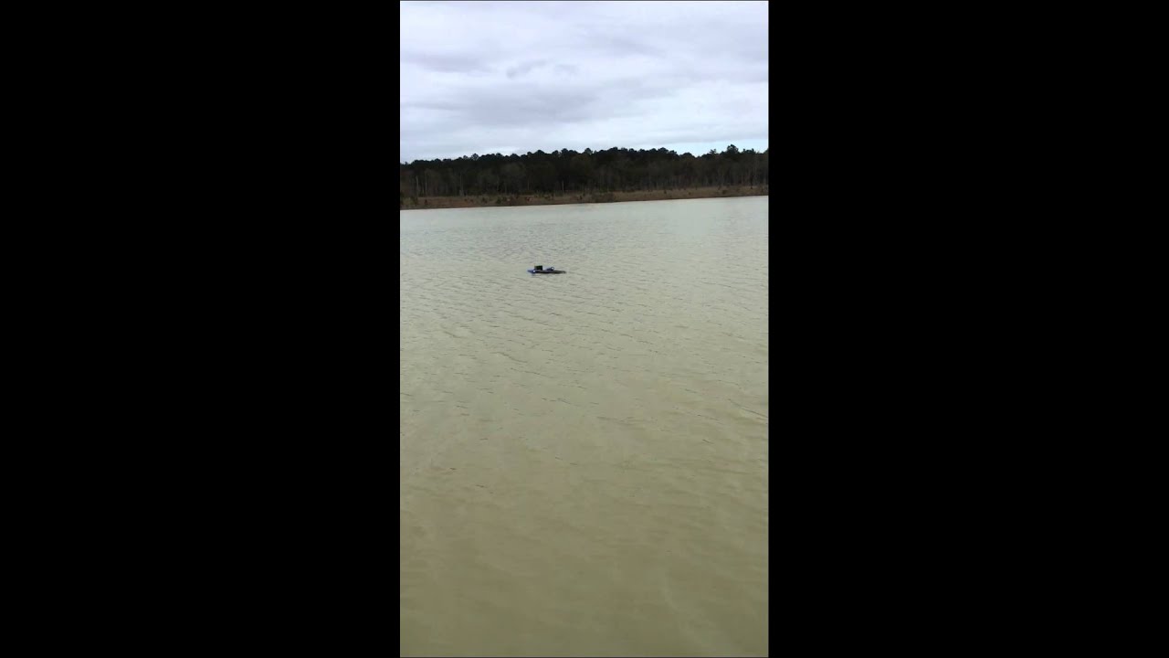

                        #56
                        Here's the recovery in action. Sorry I didn't get it from the beginning when the boat was way out on the water. Didn't think about it till it was too late.
