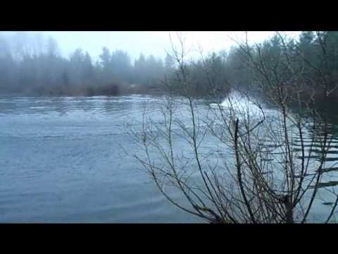

                OK, todays run: SK 180's,FC 645 props,T-600 1400kv motors on 5s
                  #353
                  Nice that you got out to run,
                  And It look pretty stable on that run.

                    One more notch up for the batteries and I think that'll do it.And fix the rudder pieces.I hit something good. These rudders do not kick up like they should.Parts request has been sent to HOR. I need new cables/shafts if anyone has any ideas.

                      Looking good!
