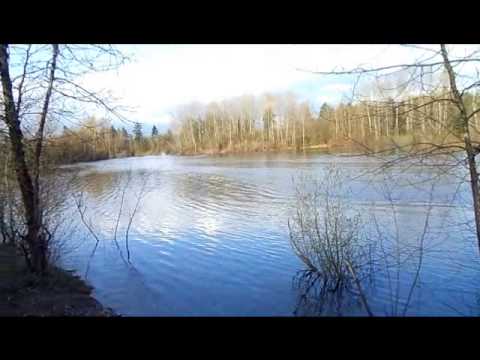

            About like this
            Haha,it was the only flip. Think I have some free time to weight the nose before this weekends run.

              Looks like it still need some more weight infront of the hull. Can you move the batteries forward? does it have extra space?

                Lots of extra space up there Tags, I have put some lead in the tips and the sun shines now.Lake's not to far away.
                  #398

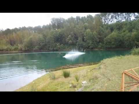

                  Got her out. CG is 34.5% on this run.Top speed on the ET was 55mph. It was just the local water hole. Going to try a bit more weight in the nose next run before I go rearranging things.

                    Hey looks like fun,
                    Did you set the boats stingers to neutral and try it yet ?

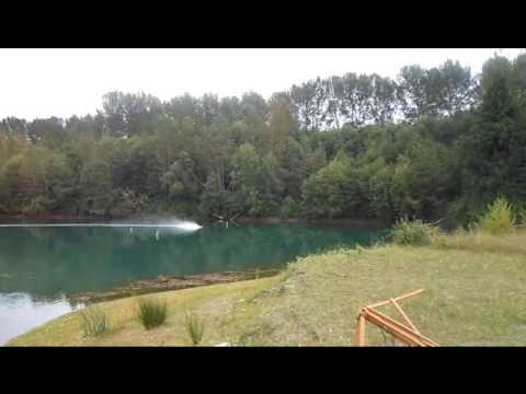

                              As much as I like how this thread got left there by my friend "tags", IT is time for an update. I got a new Eagle Tree since my old one finally got kaput. Awhile back I took the T-600's out and installed a pair of 2200kv's.Then got "work busy". So I finally got some time for boating and decided to try some things out with this thing,starting with setting the timing back down to 3.25 degrees as these 2200kv TP4092 motors are actually D wind and not Y as I thought. I di this morning drill a new hole in the rudder blade and bracket so as to get the rudder standing straight in regards to the water. This did alleviate the bounce as I thought it may. But created another problem,check vid
                              She developed a strange "wag" in the corners.Sooo... I put it back where it was which took care of the "wag" but alas,the bounce returned.
                              I bested 51mph with the FC 648 props but melted another connector. I am not sure if this girl has just got too much mass to push through the air or just too heavy.I did register high 90's and even up to 120 amps on the outside motor(which happens to be the problem one). I guess I'll try smaller props or perhaps shortening my ESC/batt wires. ESC and motor temps were good.
