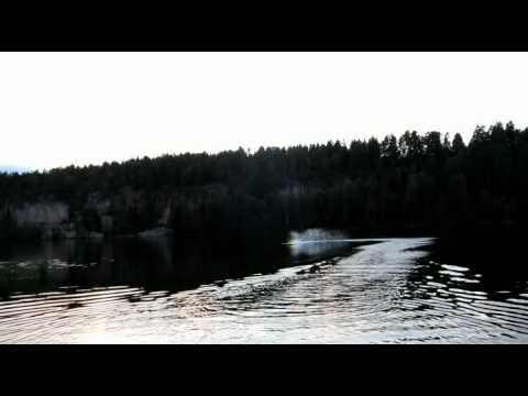

2 sets of lipos today, barely made it before it was to dark.
Sorry about the wind noise. 45-90c lipos first, then 65-130 later in the clip. Temp readings at the end.
It feels ok, not as strong as my friends mystic with the same setup though . Also it has some slight stutter as you can hear @ 1,44-1,46 and 2,25-2,27 in the clip .like it's cutting out a fraction of a second
Running a x442 in this clip. Will test with 642 an 445 tomorrow.
Drammen rock City
Looks great! I think the boat is really dialed in and very quick, do you think it is just you who thinks it is slower than your friend's?
I hear the stutter, but I am not knowledgeable to say anything.
In any case, glad you fixed the ESC and thanks to drwayne, I learned something very important!Too many boats, not enough time...
hehe maybe. I'm just impressed with the mystic hull, better molded than my geico, that's for sure. I think I will try to add the mystic rudder during the winter, less stuff in the water 'behind there'
besides that it's running again, more packs tomorrow , will report back then to let you know how it holds up :-)Drammen rock City

maxmekker should take this to the video thread so lots more ppl can see and admire and commentOriginally posted by maxmekker View PostMore testing today,and it's holding up nice.
Only issue is the 65-130c lipo's and the m445 prop. I only had one pair of 45-90c so I could not test that and the m445 to se if that had any effect.
6 min's clip ore skip to 2,00 to see the M445 run. Not sure why, maybe anybody have a theory..
[/video]
I see&hear the boat at speed surging hophophophophop on the prop.
X series props are low lift, but still too much for yours... x642+x442 show this by hopping the backside around badly.
Or.. and at 2.19 that bent edge made me wonder..are the props not sharp ?....
This will kill the esc due Amp spiking as it loads/releases on the prop.
LMK W
ps.. Love the great vid work showing temps and props.. where are the girls watching and cheering ?Wayne Schutte PhdCSE BaSE BaEE. Australian, & damn proud of it
YOUTUBE
Haha you are to funny. :-)
Well I dont do my props , I got them all done from funrcboats . I know they should maybe be DT ore maybe eveen sharper , but I can't sharpen props for sh....
The one I have used mostly, well all the time infact (since , like you point out, the boat is heavy on the whawhawha hophophop etc ) is the M445, that makes MY geico the most stable. I normaly don't use the X props I have, they work wonderful on my FRIENDS mystic, the boat flies with the X642 prop, and almost zero hopedihophopedihophopedihop, but he has been lucky with the mold of his boat. No need to fix the transoms, and the rudder assembly is wery clean from proboat on mystic compared to that on the geico boat.
Anyway , as you can se, it wont run on the 65-130c + the M445. I did not have another 45-90c lipo pack with me to test if that had any cause, next time I will :-)
I will drive it like it is for the rest of the month, and then it's on the shelf, and I'll just get a new one next year.
ps: the girls were in the bush's behind me getting ready for skinny dipping, unfortunately the camera was low on battery :-\Drammen rock City
