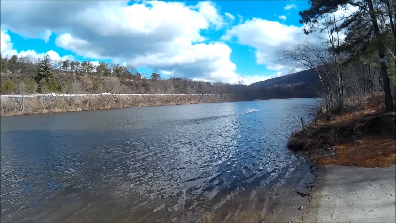

                sure was nice out yesterday . about 55 here . gave me a chance to test out the cnc prop and the garmin 101 .
                notice how the cnc prop uses alot of the drive dog threads . i put blue loctite on just to be safe .
                the cnc prop is all ready to go for you ,its pretty thin/lightweight and sharpened .see my speed at the end . boat running kinda wet ,going to raise the prop and try another run and see if i get a little more speed .
                what you think ,running a bit wet?

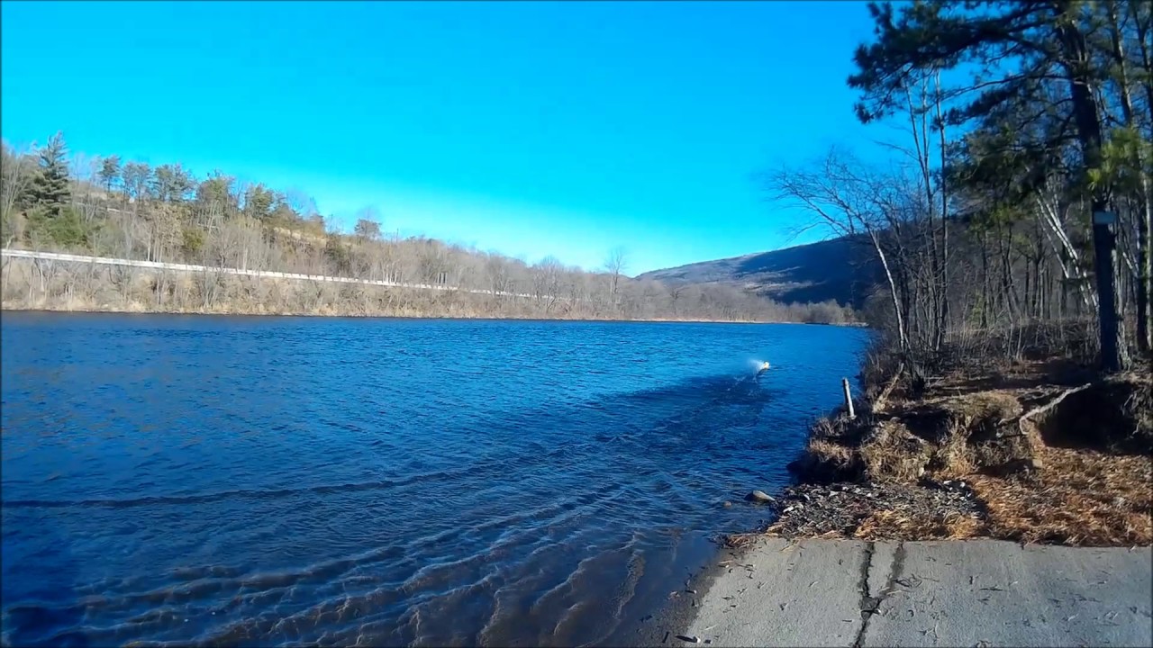

                    #99
                    todays run . the octura m440 seems the better choice over the cnc 42x1.6 . gets up on plane faster ,almost the same top speed .
                    the day i shot the cnc prop video it was 55 degrees out and water a little choppy . and i got 32.4 mph .
                    today was 45 degrees with winds of 10-20 mph ,choppy water . you will have to watch the video to see todays top speed .
                    something interesting happened today .watch the video to find out
