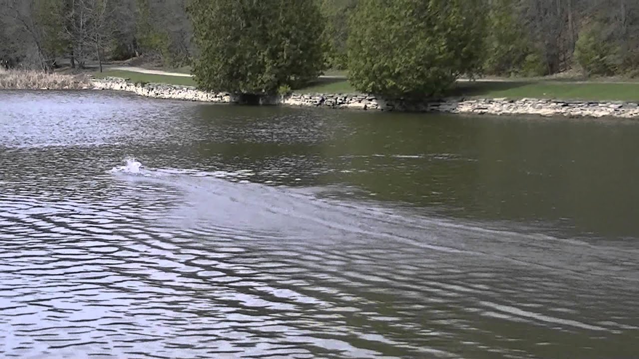

                      #130
                      Man I think I got it running at its best around the last 3 min I get some good cornering.

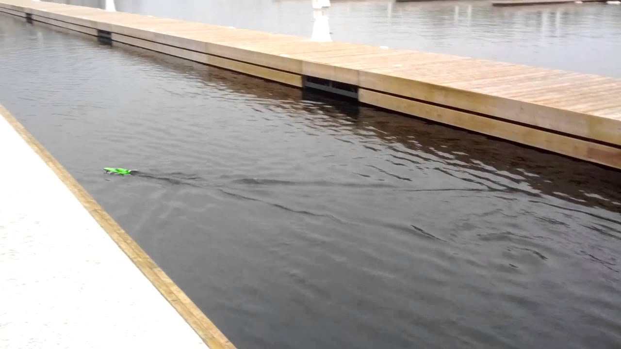

                        #131
                        Went out today and yesterday and did some runs on #3 timing and I seem to have it running a bit better till today when I was doing a full speed left with full steering lock that the boat decided to hit a wave and roll over
                        sSo anyway I had to fish it out with my fishing rod and tennis ball but I did get it out with no water inside. Here are some videos of both days.
