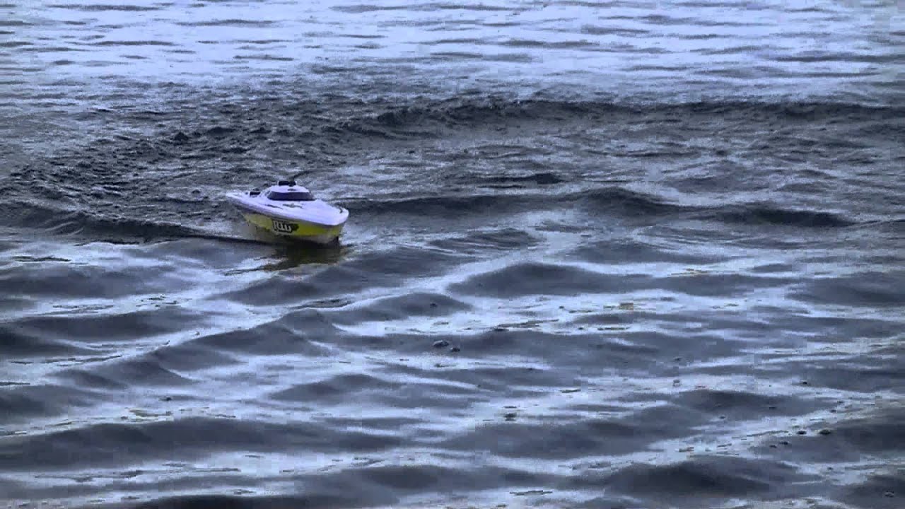

    Hello people I'm new to this Rc boating hobby and I have a stock Rio ep. I am running a 7.4v 5000mah NiMh i would really like to upgrade the motor before the esc and was wondering what motor I can use with the stock esc even if I have to cut down runtimes to cool everything down. Any help would be greatly appreciated.
    Here is a video of my second run with it.

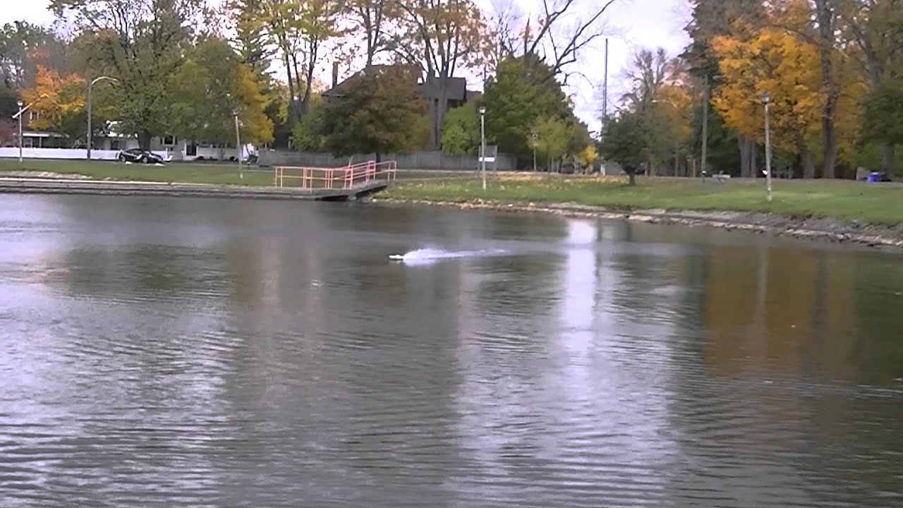

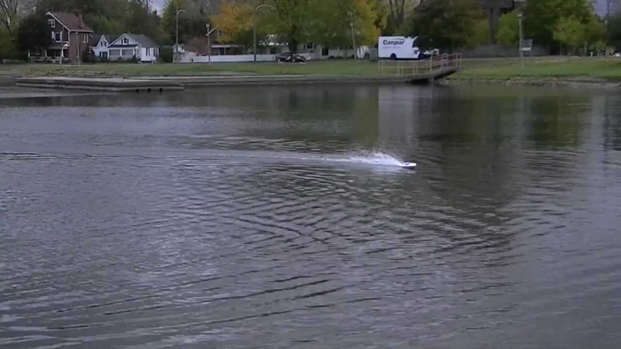

                            Well I went out yesterday and tried the new esc and motor here is the video I got. I also have a video of the first 1 min run with fresh 7.2v which I will upload later.
                            I kept picking up leaves on the prop thats why Ihave to keep coming in.
                            Here is the fresh battery video.
