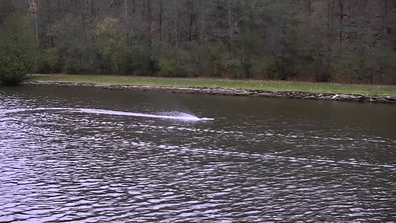

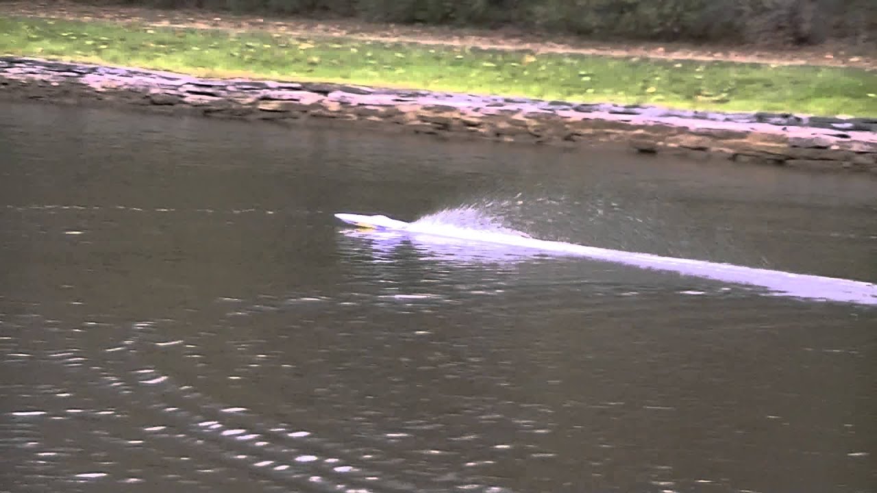

                                I went out todat and tried both props the stock 42mm and the new 40mm not to sure which is faster here are both videos anyong have any idea which one looks faster?
                                This is 42mm
                                This is 40mm
