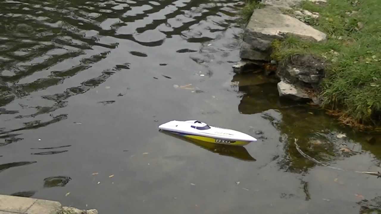

                        Well I went out today and got a 8.4v 5000mah can't wait for some good weather to test it out hopefully it will give me the extra speed I am looking for. When I get good weather I will take it out get some video and post it so you can see how its going. I was also at futureshop today and seen a traxxas brushless setup for 149.99 and a bigger one for 199.99 which I think I'm gonna get when the snow comes then I will have a good brushless setup for next season. Can anyone tell me if that is a good price for a traxxas brushless setup?
                        I also took the torque ring off the 12t and that boosted the rpm's up a bit I have a video and I will post it when it is finished uploading.
                        Here is the video.
