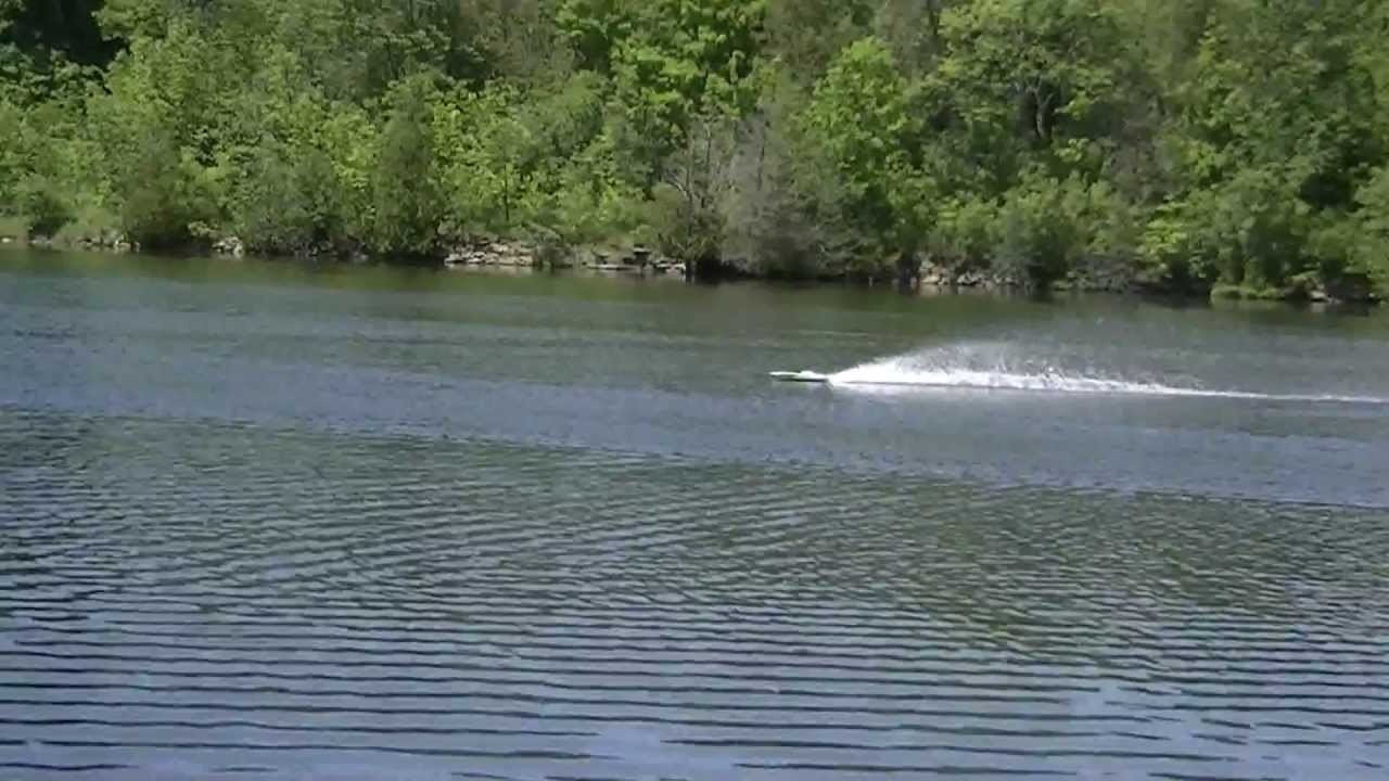

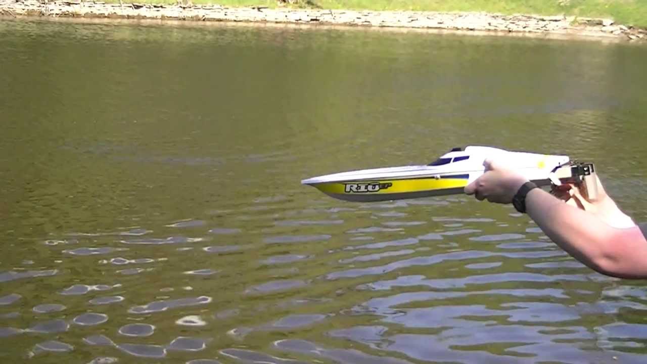

                    well I went out today and did some runs with my new 3s1p and WOW what a speed demon now to work on the setup to make it handle
                    better. Here are some vids of the runs don't forget it still needs to be setup these are just test runs for now.
                    If anyone has any suggestions on how I can make it run better i'm open to ideas.

                      It is torque rolling from the power and also the prop is to big,
                      Also my cell sits at the back of the transom and adds more ballast to help control the torque some.
                      Longer and wider trim tabs may help to,
                      But the x440/3 prop is also needed to help with that.

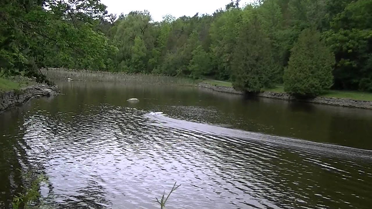

                              Well I went out yesterday and got the boat tuned to go full out with my 3s1p lipo and man it fls. Its running bit wet so I still have to get I fine tuned but at least
                              I knw it can handle the speed. Once I ge some bigger trim tabs it should run better I hope. Here is the video of my full out runs.

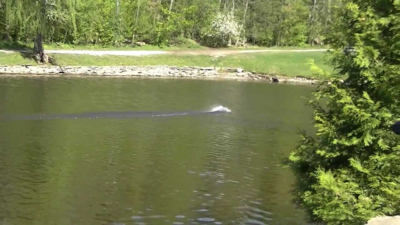

                                Went out to a new place with a few new people and got a good run out of my Rio.
                                Heres the video.
