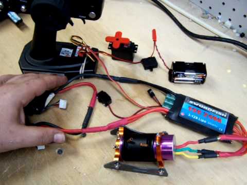

      I think I used this video from OSE as an example when I did mine.
        #48
        The manual was not clear, something lost in the translation, I just waited the first series of tones and immediately released the trigger, it seemed to arm. I then turned up the throttle EPA to 120%. I will try either tomorrow or Thursday.

          Great video Steve. I'll try it again once I'm ready to play boats again. Taking a little break after last week. Like maybe a week off. LOL
