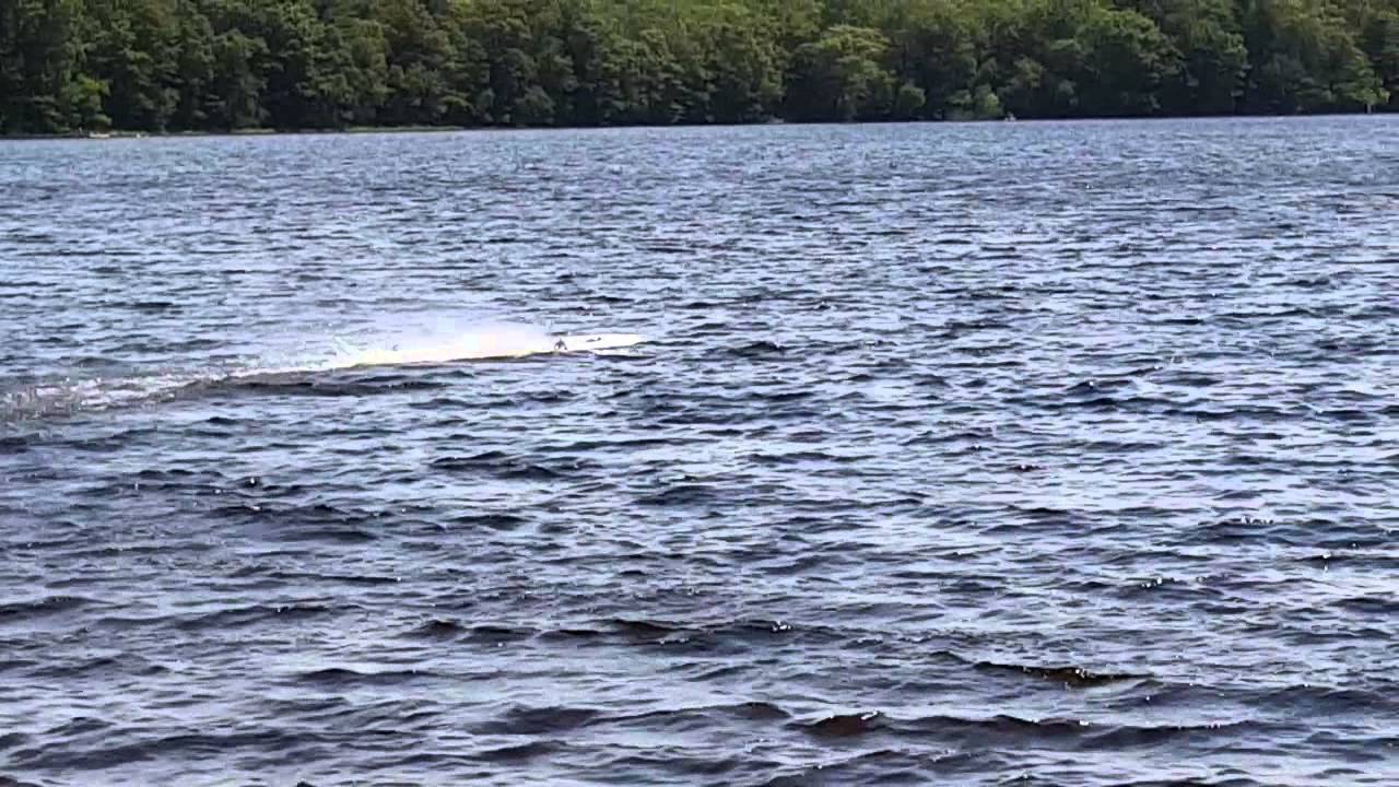

                  And here is Dana's boat, in the hands of it's happy new owner, my buddy Mike. Mike had made a few runs with his Mystic before he grenaded it into the rocks, but was finally ready to get his feet wet again, so this one was perfect for him. The wind really picked up, so we stayed with a very conservative 5s/445 setup. I couldn't believe how well this thing handles the heavy chop. Nice job on the build Dana.

                    Thanks Kevin. Looks like he's having fun! That thing is getting serious hang time lol

                      Yeh Kevin, I agree, epic build Dana! Can't wait to duplicate that build the best I can! That first run it was just gliding so smooth... I'm pumped
