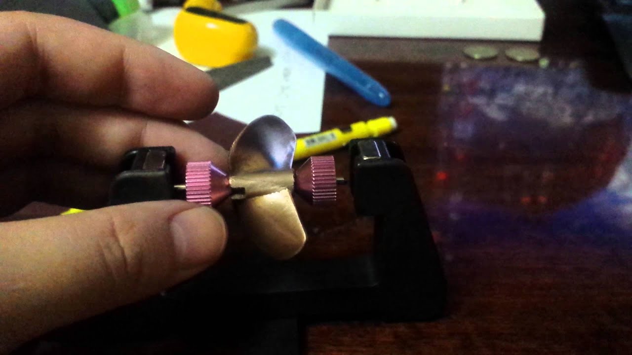

                            #88
                            Hi to all! My boat has a new prop for now. Firt self made balanced prop.
