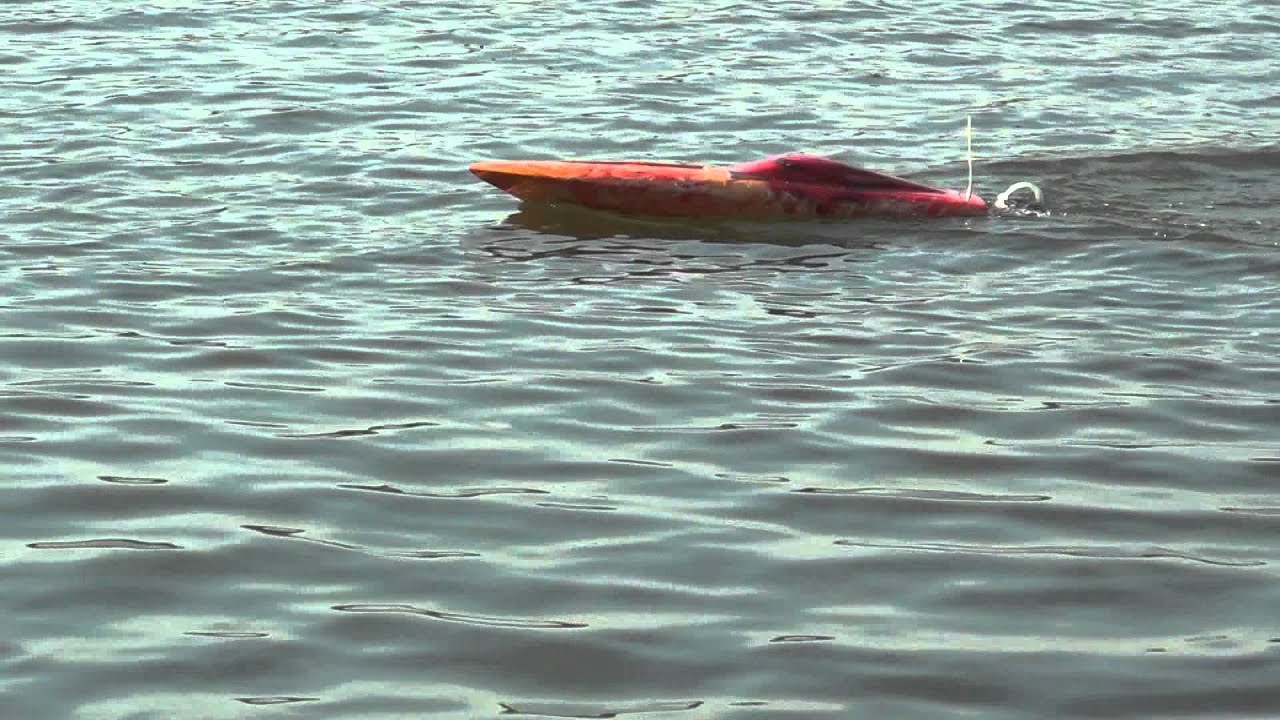

        I think you're running your boat wet

                Battery temp is way to high. Max temperature is around 50°C. Any hotter will damage your lipo's.
                Boat is also running a little bit wet. Running your boat with less hull in the water will be beter for
                your current draw and will extend the lifetime of your lipo's.

                      There is a reason why you burn of your esc and your motor failed you now. I would really change your cg and run your
                      boat not so wet because even a completely knew motor will fail in time if you keep it running like this.

                                I have a question about running boat wet. Wha can i do to solve this problem? I was try a some stinger configuration, i was try a some battery position. But i can't up the hull from the water.
