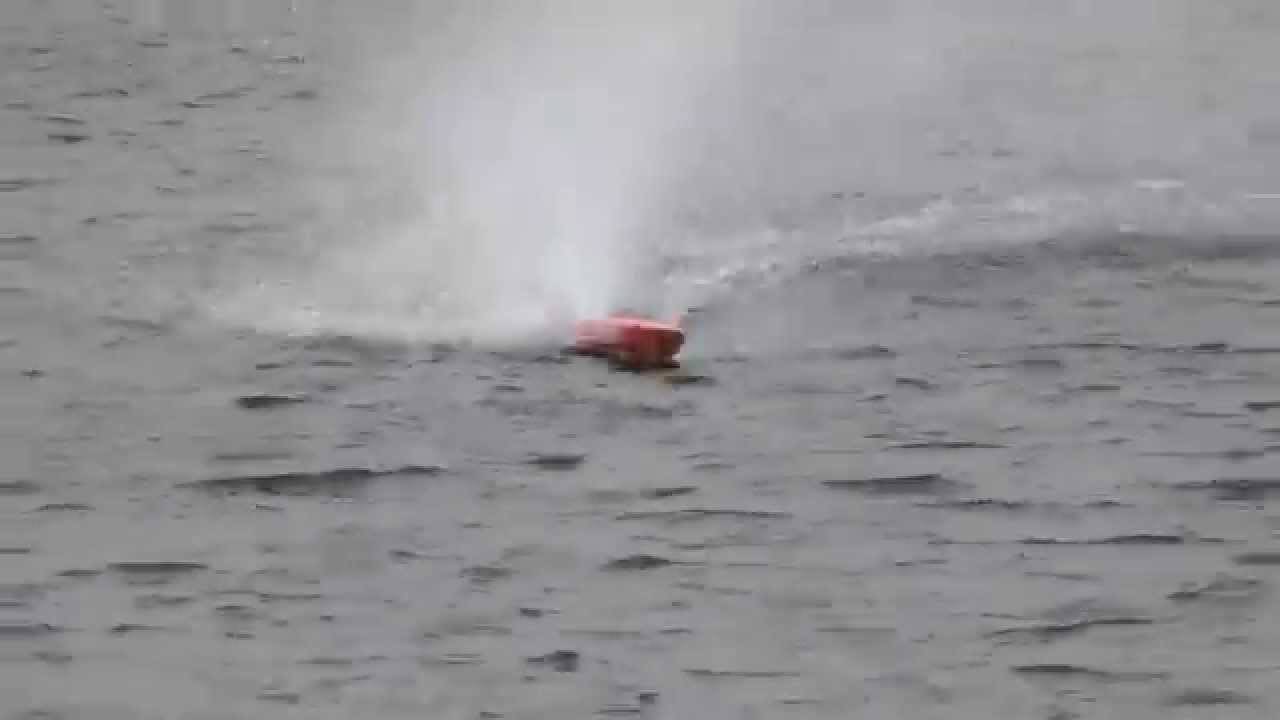

                            • Darkcyber
                              • Nov 2013
                              • 51
                              There are the first run of the Red Dragon.
                              We have only one good video, sorry. Runs will be continue...
