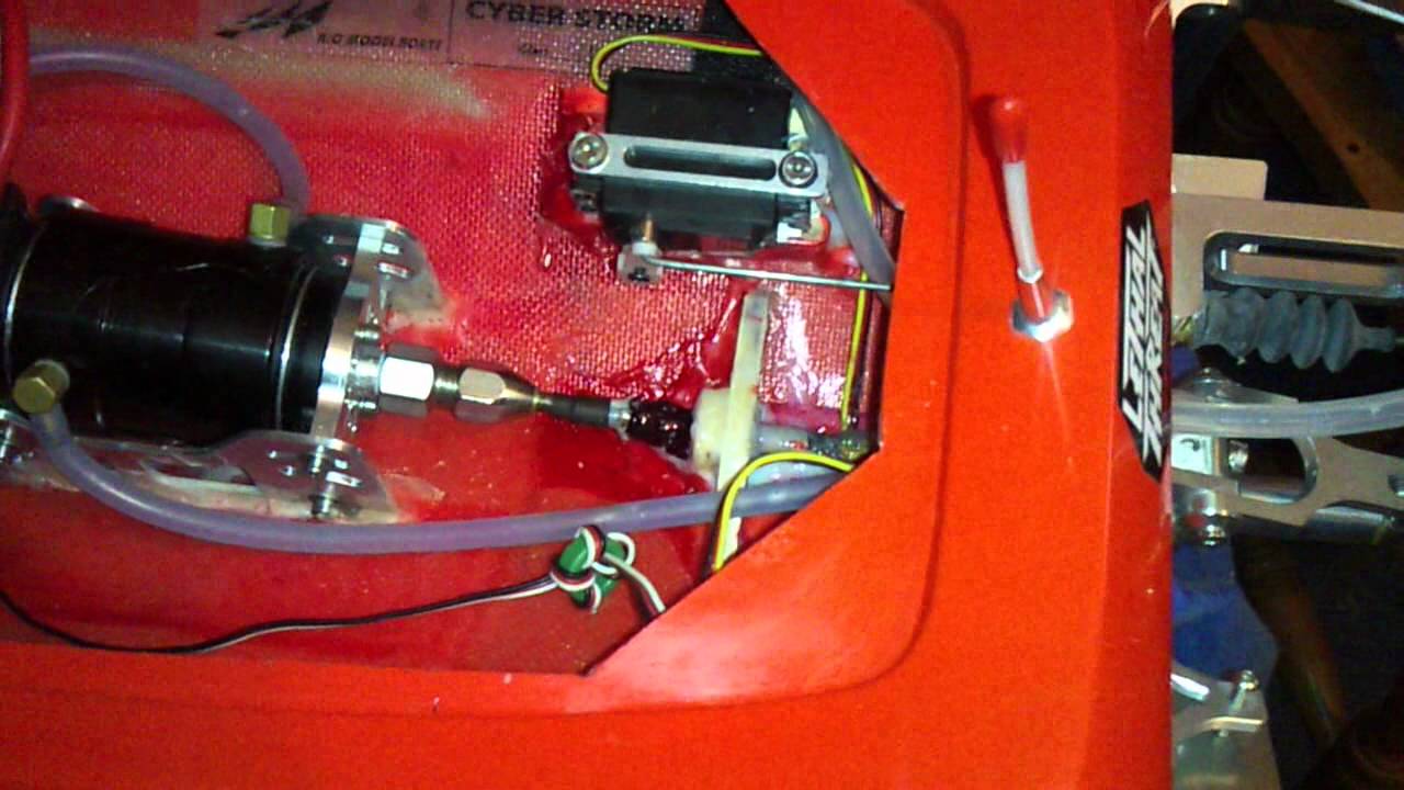

        Thinking of getting the 1518 1800kv to run on 5s in this boat. It's such a light hull and I don't think the 1515 weighs enough. Maybe a 1520?? Need to try to get a good run on this motor first. I have just heatshrink around the flex and the stuffing tube. Since the stinger is in an upward position the water seems to be coming up the shaft a bit more and the silicon tubing wasn't good enough.

                  A few alterations. Firstly battery stand was too high and I was struggling to get my packs in and out so I put it flat across the hull instead. Lot easier now. Battery stand could fit 2 5000mah batts on nicely.
                  Done the heat shrink trick on my flex shaft and stuffing tube, keep water out of the Hull. Hate the capillary effect
