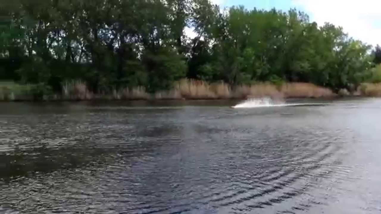

                          I was using a NEU 1515 / 2200KV. 2 3S 4500 cells in series, so 6S. I ran the cells as far to the rear as possible. V942 prop. The 3 blade prop makes a huge difference, it seems to keep the nose down. I have a ICE 240 ESc, and its pretty big, so I ran it on the left side next to the motor. http://youtu.be/4PG9dqwECFQ

                            So what happened to the hull, any severe damage? That is no small feat you accomplished by cramming that ESC into the hull!
                            While I admire your speed, I must say blow over like this gives me nothing but grief. I know everyone has a different take on this, but just seeing your boat crashing made me cringe! lol...

                                Well, after the above crash, you can even hear it bounce up on to the dirt, nothing happened, I set it back in the water and kept going. This boat has crashed countless times over 55+ mph and I still drive it today. The off-set rudder bracket is not very sturdy, so I have bent a few of those, usually just bending it back into position.
