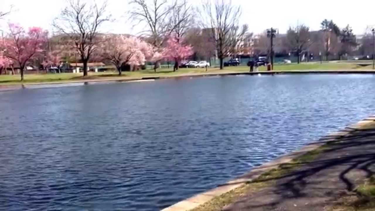

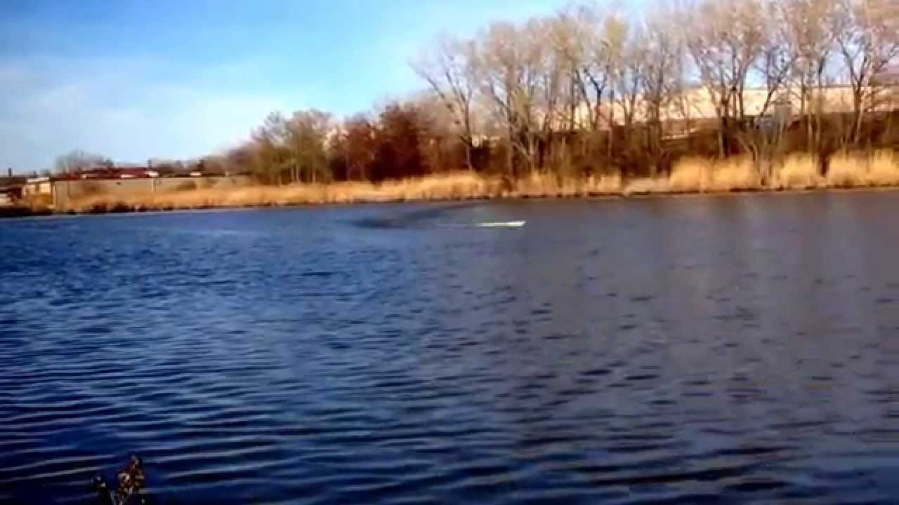

          Blue printing helps. Before it bounced at half throttle with lipo forward. Check out second video with battery at the sweet spot. It seems bounce free, winds was about 14 mph.

                      My strut is about level with the sponson and I raised ot an 1/8 up so it dont touch ground. How fast do you think im going in video?

                          Know what. My boat probably is ok. In both video's its windy and I drove my boat in the wind. It is suppose to flip. I will take the advise and try smaller prop. Anyone in the NJ area wanna race?
