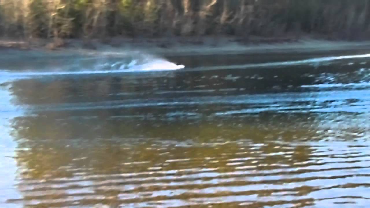

                              I have raised the strut a bit, how is it running now?
                              • Luck as a Constant
                                Make Total Destroy
                                • Mar 2014
                                • 1952
                                It's looks better, but how do you feel about it? Improvement?
