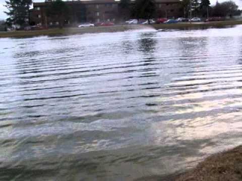

                              Big boats not only cost big bucks, but get ready to go through 4 boats worth of lipos in 3-4 minutes with a 50" boat. It's definitely not the most cost effective way to do FE boating...
                              As far as the Eagle boat, I'm surprised it didn't do well with the 2028. Maybe he just gave up too quickly? I ran a 5692 in mine and I felt like it could have used a bit more motor and lower kv/bigger prop. I ran a x457 on it and it was defintely on the small side, this was the first run:
                              www.keithbradleyboats.com
