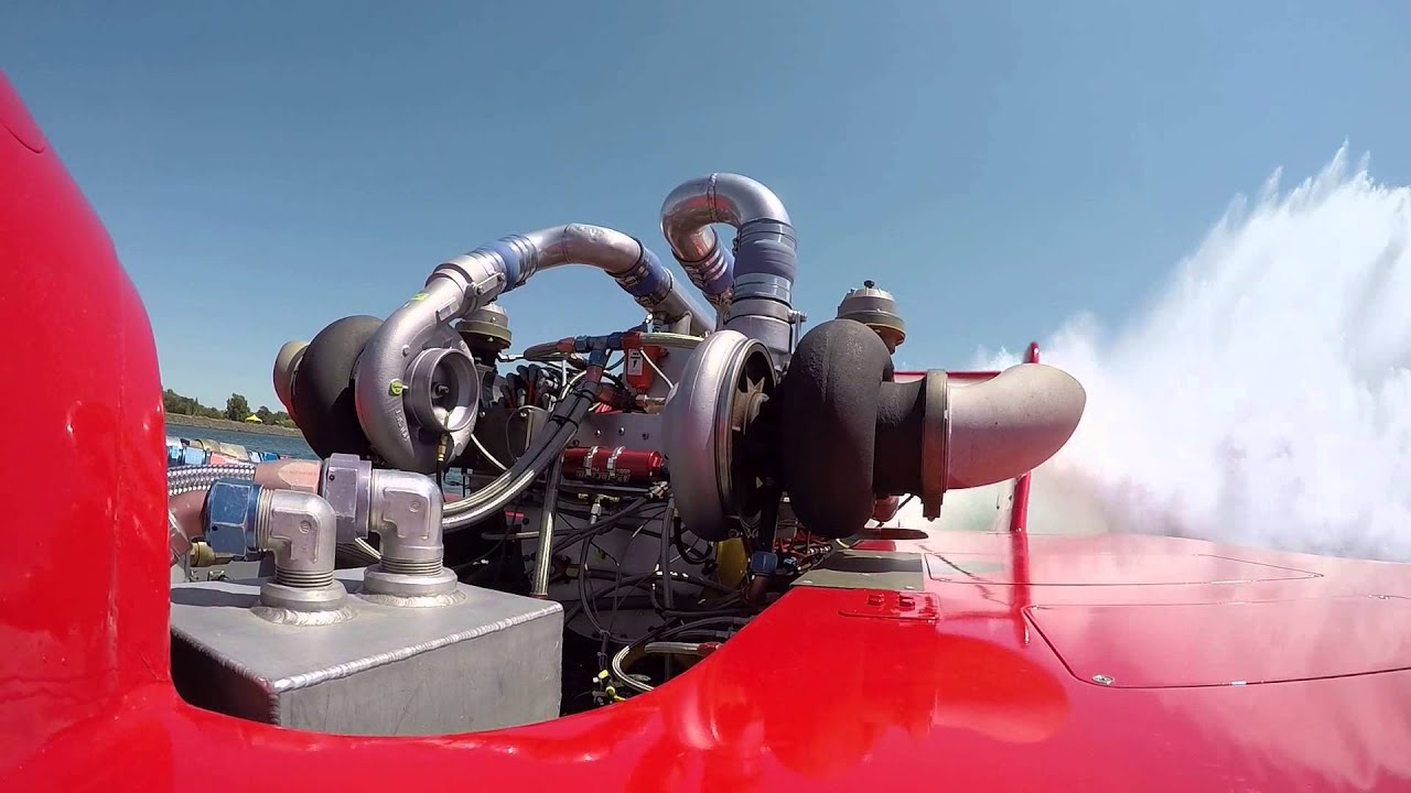

            This is for you. Check out the water injection into the turbos.

                Thanks, double awesome give me a pack of Allison's duking it out with a flock of Rolls Merlin's any day.
