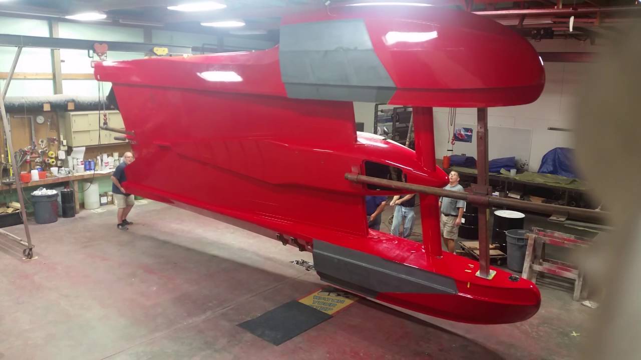

                  Thanks for that.
                  I came across this little gem which gives good views of the ride pads & the rear sponsons. Cool.
