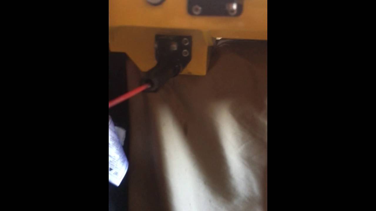

      I was hoping that wouldn't be the case but don't mind doing it if it will keep it out. I did a short video of where the smut is coming out from using the contact cleaner. Will post shortly.

        I would say about about 1/4 to 1/2 cup of water gets in. Usually sits in the back near the 4 bolts for the struts. Do you thing spraying plasti dip on the inside around those nuts would help or just silicone all the nuts?

            Look where the screws are. If you look closely you will see the cleaner coming out. I should of taken the video while the strut was dirty.

                Those drives are a 6 piece design. They just need to be tightened up, just don't over tighten them or you'll crush the plastic socked washers that the strut ball sits in. You don't need to remove the base off the hull. Just the 3mm adjustment bolt and then use an open end wrench to loosen the nut that holds the strut to the base.
