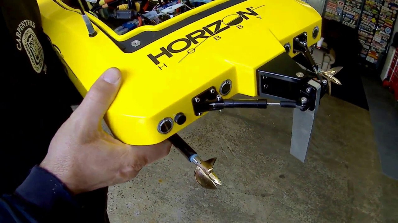

            what about cracks in this clip?

              My Zelos developed lots of stress cracks in the paint on the bottom also. I added another layer of fiberglass and resin while I was in repairing the transom when I flipped into a curb lakeside.. nice and strong now but still has the paint stress cracks. probably nothing much to worry about other than looks..

                  The sloppy rudder bushing is a good opportunity for someone to make an upgrade part. Don't mean to be negative however, the strut bushings would wear similarly fast in Geico's and the only reason why I can think it happens is because of the material used is too soft.
                  Is this common to many of these boats?

                    On mine has that play from like the start that I got the boat
                      Mines is doing the same thing. In all fairness I think it happened when I recently flipped my Zelos. The area in the center under the battery / electronics tray flexes pretty good on my hull. That area carries a decent amount of weight with 4 batteries. I think when mine landed (good side up) the weight of the batteries flexed that center section and caused the gelcoat and paint to crack. I'm also adding a few layers of CF cloth to that center section under the battery tray in hope of stiffening it up some. Also putting a some in back in the strut area and adding the 1/16" CF plate under each strut in back like Keagan did . As for the spider cracks I may lay some flat black vinyl down the center on the bottom to cover them up and seal it from the water
                          My bushing does not noticeable play in it.
