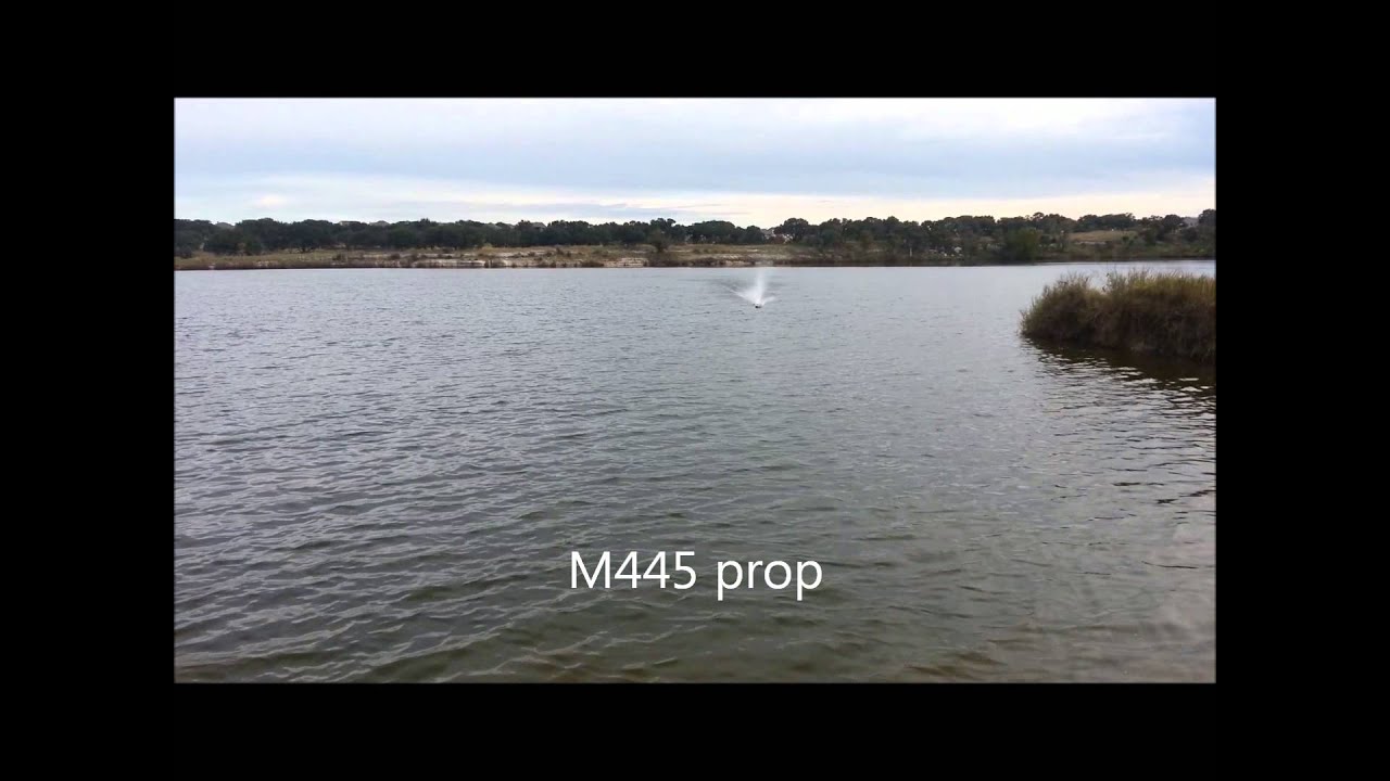

                      Follow-up on this, got 4 good runs in today.
                      Throttle travel at 100%. Light chop. Strut centerline is 0.43" up from very bottom of hull best I can measure. Turn fins all the way back and all the way up. Trim tabs are neutral or maybe up just a touch. Battery is pretty far back, not touching the motor, but maybe 1/2" short of it. Light radius on rudder and sharpened.
                      M445 S&B with Dinogy 4S - 42.9mph (motor temp 90deg, ESC caps 105, battery 115)
                      X642 S&B with Dinogy 4S - 41.7mph (motor temp88, ESC caps 90, battery 110)
                      X642 S&B with Nanotech 4S - 40.0mph (motor 90, ESC caps 90, battery 105)
                      M445 S&B with Nanotech 4S - 40.4mph (motor 90, ESC 85-90, battery 115)
                      X642 was a bit more planted and very smooth. The M445 made the boat feel a little more loose and experienced a touch of chine walking.
                      Those other Nano 2Ss in series I mentioned earlier in the thread weren't putting out correctly.
                      Now to play with setup a little more and try to squeeze out a bit more speed.
                      • AustinWolv
                        • Sep 2013
                        • 175
                        #41
                        Changed the setup slightly on the Revolt.
                        -Shimmed the strut mount on the right side to get some deviation so thrust would move the bow left in order to run the rudder more straight instead of kicked over with left trim.
                        -Moved the strut back down and about 0.4" off the very bottom of the hull
                        -Move the battery back to just short of touching the motor
                        -Trim tabs neutral
                        Using M445 S&B this morning on smooth water, hit 48.1mph on stock motor, ESC, and 4S 4000mAh Dinogy. I'll take it.
                        Boat was a bit squirrely as it was riding on the very end the hull, so any wake or small waves would make it start chine walking, but otherwise, it actually rode very well on smooth water.
                        It was nice to not have so much left trim on the radio, and boat was running very straight at full speed.
                        Turn fins are still all the way up and angled back fully.
                        Also ran a X642 S&B again immediately on the next run and the boat runs noticeably wetter and slower.......low 40s, so it handles much easier of course. But the battery temp was much higher after the X642 run compared to the M445 run.
                        The boat definitely likes the 45mm prop better.
