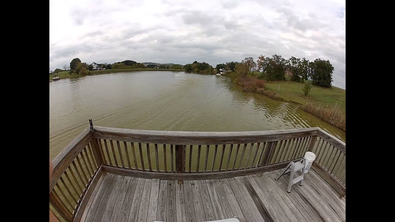

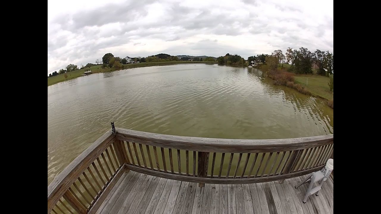

    So i went out to try the new combo yesterday leopard 3674 1900kv and m445 prop and its a very safe combo with decent speed the first run 42.5mph i finally broke 40 whooo hooo temps were esc 98 motor 97 ambient of 86 with a water temp of 76 this is a very cool running set up to say the least on the second run which was made back to back of the first run i got 43.2mph both runs were around 4 min before lvc and the temps were nearly identical with esc 97 and motor 99 so im gonna order a m545 to go on it any other suggestions here is a couple vids i made and i was running 4400mah 40c packs
