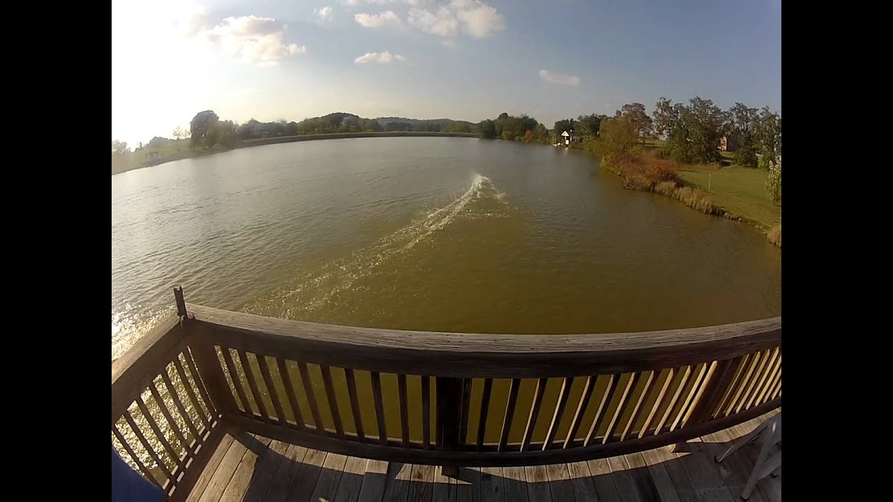

      yes i did just get it i dont know what happened 3rd run on the boat im uploading a video of it will post it when its done it never quit running just lost power so i brought it in and pulled the hatch and well you will see in a few and the temps were only about 145 on the motor im still stumped

            here is the video of the smoked motor run sorry bout the sound forgot to remove gopro from case kids were filming

              Thats a huge prop dude!!
              • Darin Jordan
                • 8332
                Definitely! It'll pull it, but only for 2-minutes or so.
                Seems like a lot the emphasis on hitting those magic top speeds on the GPS sure seem to burn down a lot of equipment.

                  Couple of questions and observations...
                  * Is your 45X68 balanced and sharpen or did you put it on right out of the box?
                  * I noticed that you have an after market speed-o. Do you know what timing the controller is set to?
                  * The boat was still running when you brought it in, does the motor still work? (oh, I just noticed you said it lost power).
                  * What kind of battery are you using
                  * What size of connectors are you using on the motor and controller?
                  It hard to tell in the vid, but the boat didn't "look" to tight to the water. However, 145 is to hot in my opinion and you did run for close to 3 min. If the props stock (NOT balanced and sharpened) it COULD be part of your problem.
