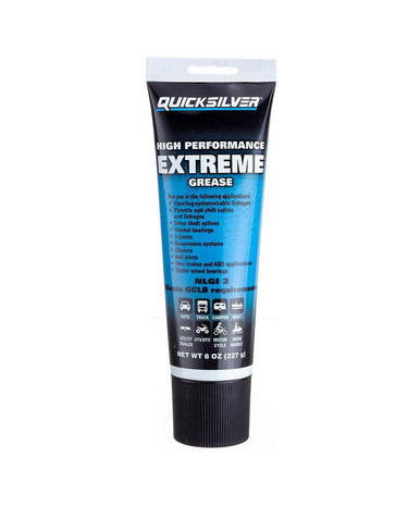

          Well, I got the Sonicwake today. I pulled the shaft out and there's no sleeve. Or is there?? I going to use extreme grease from my real boat.
          Mercury Quicksilver 92-8M0071838 Extreme Grease 8 oz. Also listed as Sierra 18-9200-2. Genuine Mercury part from Lighthouse Marine Supply.
            https://www.marineengineparts.com/me...se-8-oz-bottle
            There should be a liner in there...mine had one... And yeah...extreme grease should work fine....... like you...i use it on my mercruiser out drive.....
