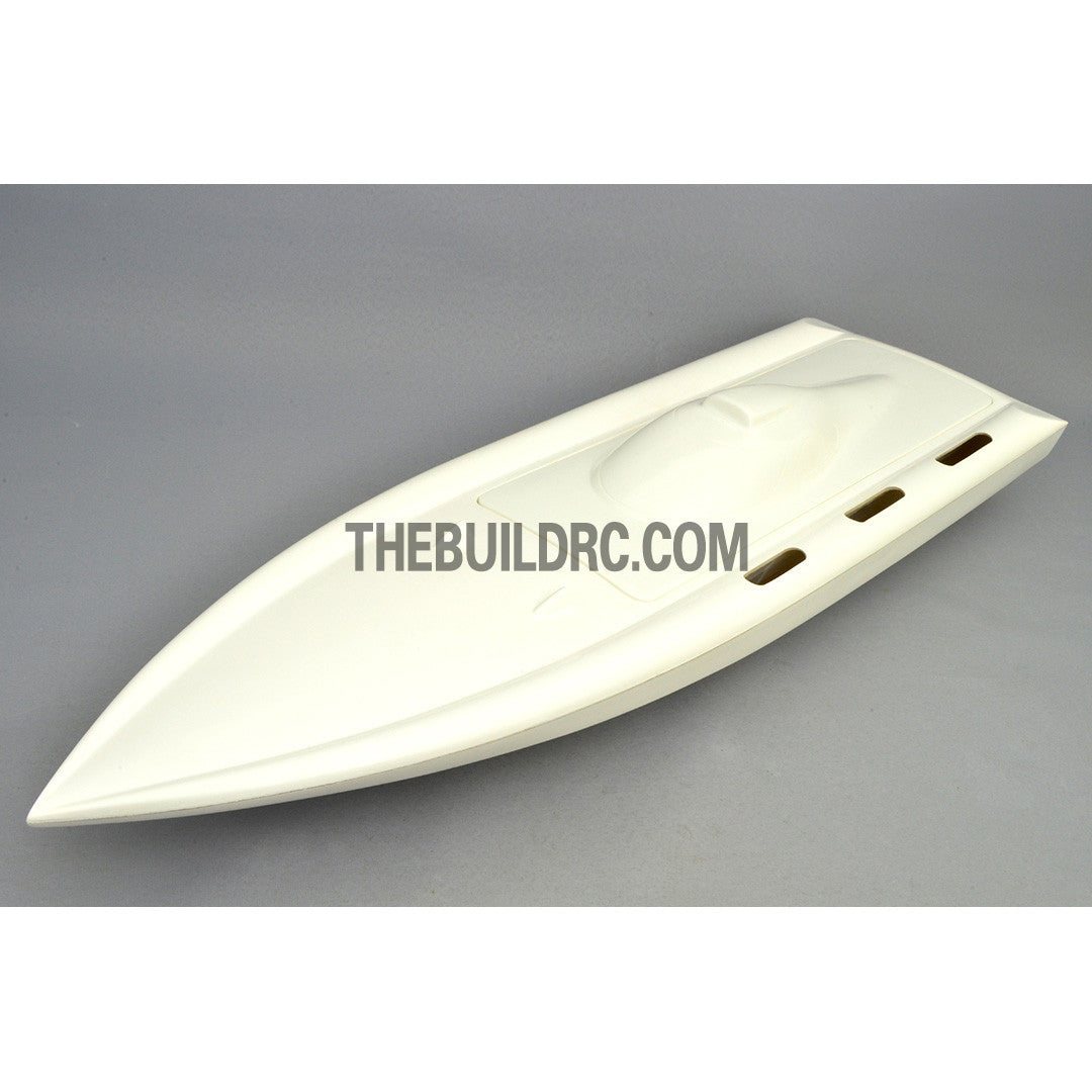

The hull is still available from the manufacturer but be advised the stock float chamber is woefully inadequate plus will probably leak into the hull. A lot of work would be needed to make a self righting hull that reliably corrects itself. This thread details much of what I did to get to the stage of a reliable self righting boat. I must apologise for the gross misuse of "Miss Geico" stickers. Following is a link to the manufacturer.
This 32" Mono 2 Deep-vee Arowana Racing Boat Hull is based on the previous version but with anti-turnover function. It is 100% handmade with FRP epoxy fiberglass and comes with a super smooth gel coating finish. IThe hull is polished to a mirror like shine with a streamline design. Wooden motor and servo mount are inclAttached Files
