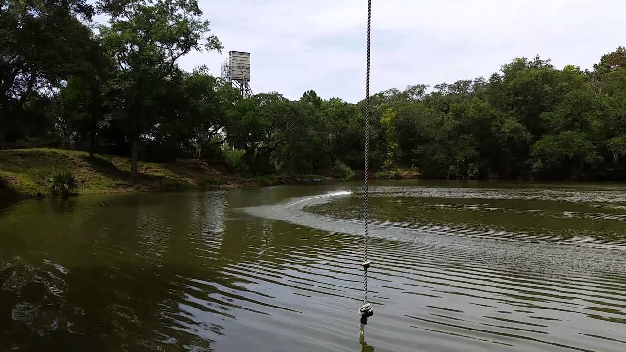

    I didn't want to start a new thread for this. I was invited by a friend to avery island today. That's where the Tabasco hot sauce factory is. His family owns it so we got to check it out. I brought my rivercat and my mini rivercat. There was one lake that was probably big enough to run it but it was surrounded by marsh except the dock we were on....I tried the rivercat in it but the chop was too bad, I actually rolled it over turning....going super slow. So then he took me to another pond which was too small to run the rivercat. ...but the mini...I found out doesn't turn too bad! It was cutting out a little but the batts had been run a good bit before I decided to start shooting video. Man the motor and esc don't really get much over warm in this thing lol. Here's a quick video of it. Pretty neat little boat....
