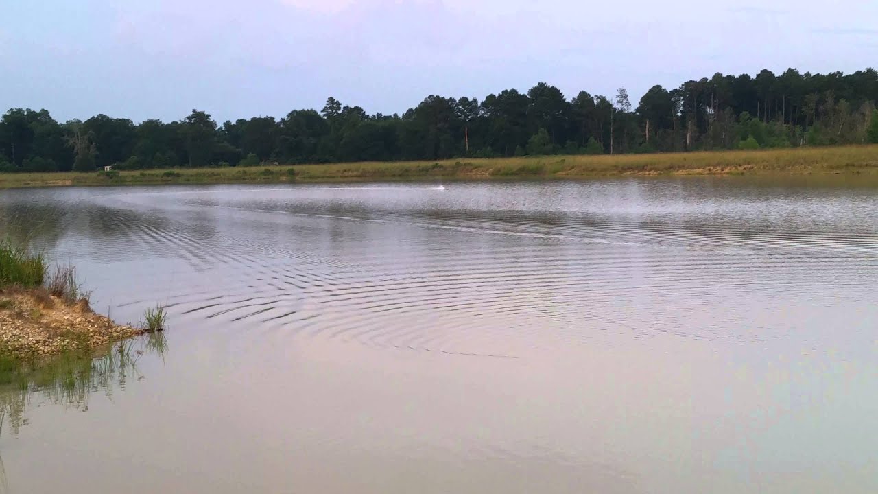

      Here's a video

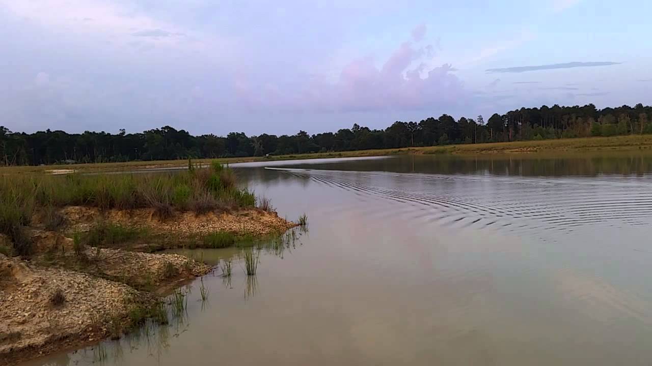

                  Here's another video for your entertainment
