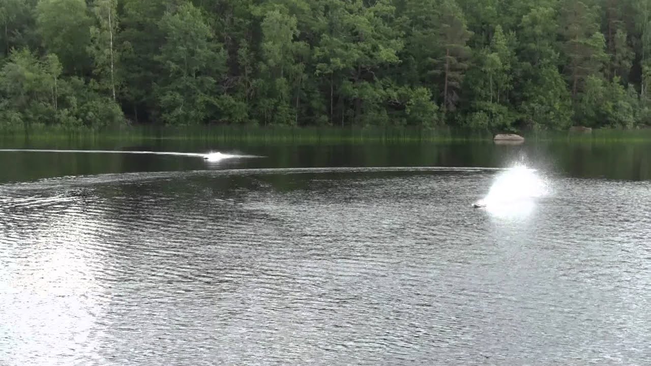

      Hull is a RCMK Flying Cat...and right now it's missing its hatch
      Motors are SSS 4092 2140 kv d-winds. I shortened the shaft about 5-7 mm (along with the extra 5 mm alu plate just beneath the motors) to make them fit. Didn't wanna shorten the motorshaft past the grub/drive dog "area".
      ESC's are T180's
      Lipos are four 4S 5000 mAh 20C. It needs a lot off weight in the nose, which all in all makes it pretty steady on choppy water.
      Props are TJM 40/3 in the videos, which are the preimer runs (about a month ago)
      25" Arrowana with Etti 2970 3300kV. RCMK Flying Cat with twin HOR Outboards. 2 x SSS 4092 2140kV. Faluga 45" with Leo 56110 620 kv on 12s.

                          Alfa. Right now I run both motors in normal rotation. I do have counter rotating flexshafts but I haven't installed them yet.
                          Right now one motor is on the workbench and I'm waiting for a new brass bushing and propshaft. Must have gotten som dirt (sand) in there because it just "stuck" and took the flexshaft with it in the fall.
                          Check 00:54. That's one propshaft almost welding itself to the brass bushing. I had to torch and knock the propshaft out with a hammer.
