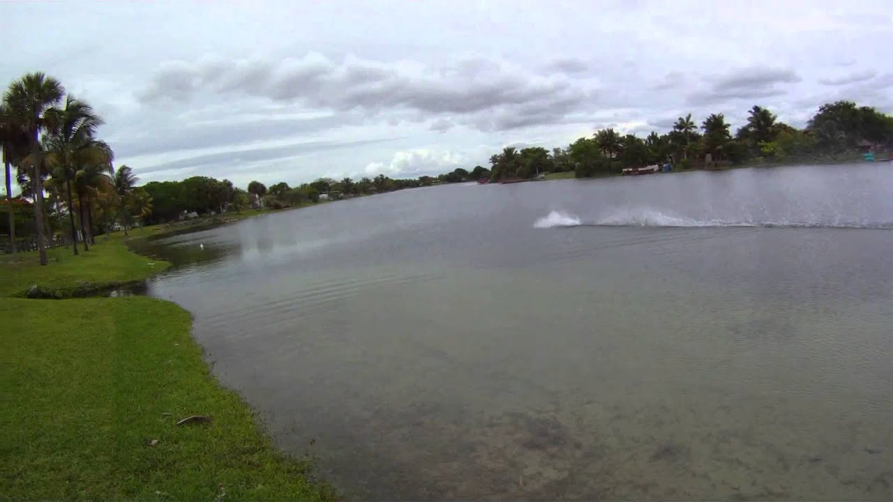

                          Here's a clip of it running good

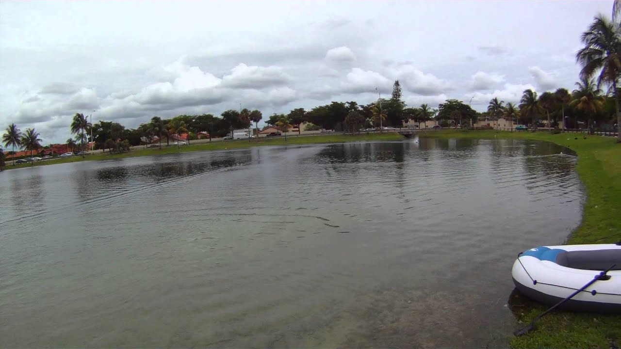

                            And here's another flip video, but this time it landed good and I slowed it down for your enjoyment!!
