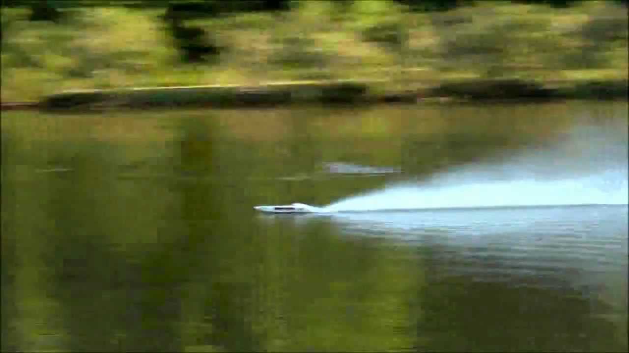

                #67
                Hey guys, is the OP still around? I wonder if he's had any success
                I read through this thread again, and it's clear we could all be talking about something different. So here's my very short vid. It's the longest pass that day and the one that best shows the "curve". In the final second or so I do give a right turn command once I come off the throttle. (you see the rooster drop) The rest of the pass is full throttle - no rudder command. This is with a ton of left rudder trim already dialed in.
                If you guys can post a vid of what your boat is doing, we can all better understand what each is doing.
                For me, my suspicion is torque roll + prop walk. My starboard sponson is riding much wetter than the port side. I used to run a much heavier pack in the port sponson. (4S+2S, now 3S+3S) I also had a larger prop this time - m445.
                Disclaimer: I hereby accept the potential loss of motor, ESC, entire boat, or credit rating, and forfeit all expectations of success.

                  @Prop-a-Gator- my genesis started to act like yours few days ago.the latest changes made before that where:
                  1. replacing the stock driveline with a 3/16 one.
                  2. using a bigger prop (45mm instead of regular 42mm).
                  So that the "curve" at high speed is a result of one of the above.
                  The problem is that with the new driveline and bigger prop, the prop itself is much closer to the rudder now,almost touching it.
                  I will try next days with the old prop (more clearance to the prop) to see if is the same effect.If so,the solution could be to offset the rudder.
                  One of the experienced guys at my club suggested the "cuve" can be also a sign of an aging servo that is starting to malfunction when pressed at high speed.
                  Worth to try with a different (new) servo.
