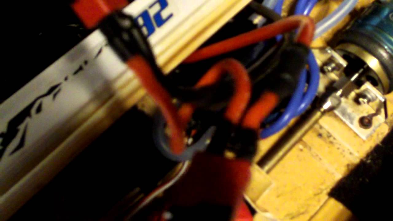

                          OK Doctor, I know you think I'm nuts (that's OK ) but for your diagnosis I made a video. Hope you can help...
                          I'm only using 2S 5000 40c ...everything is wired correctly. As I mentioned the motor is screaming. Although I did this for a very short time it is definitely hitting the 50,000 rpm range without a doubt.
