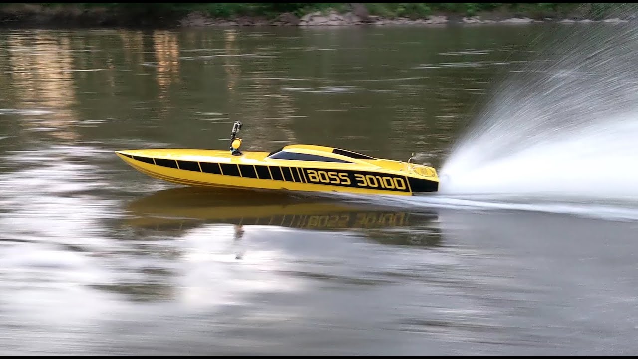

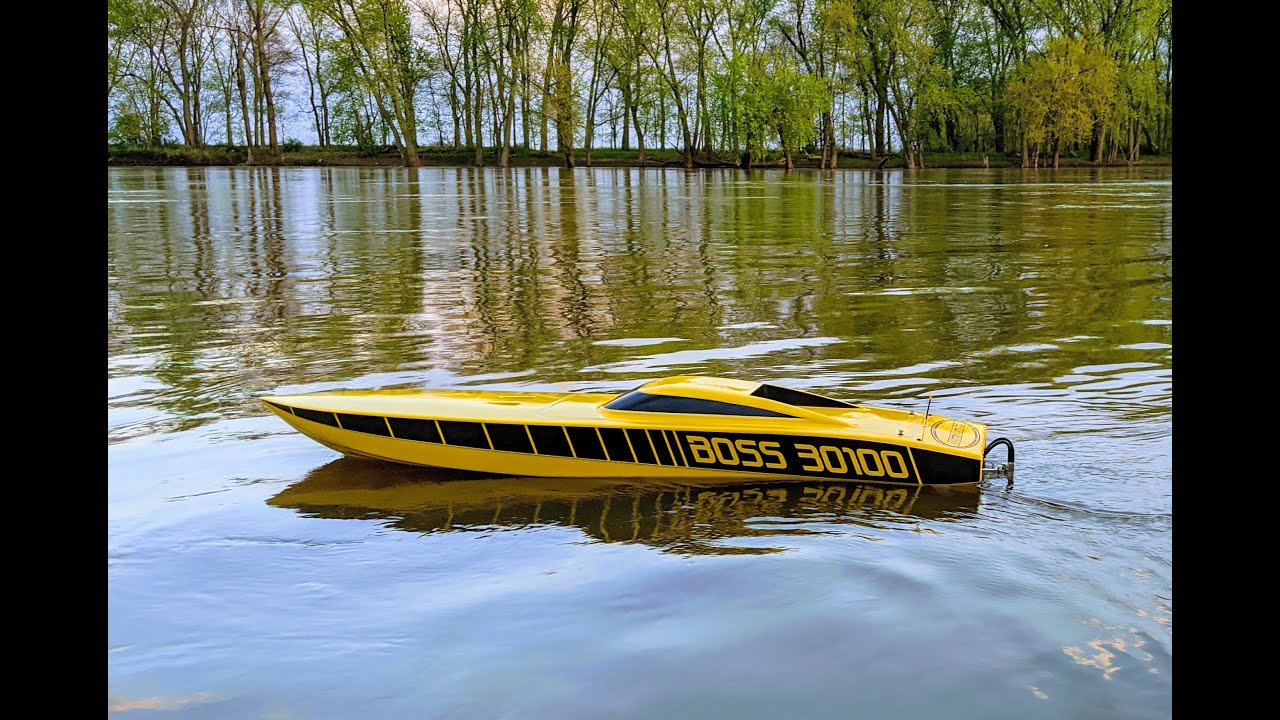

        Had this thing out on the water a few times since my last post, with all this good weather we've been having. I've played around with a few different props. Taken some more videos. All in all, this boat is a blast, and I'm very happy with the results so far. Not too bad I don't think, for a first time boat build, and for the size it is.
        My original prop for this build was a 1.4 pitch 62mm 3 blade. I quickly found out it was not enough prop for the boat. I bumped up to a 1.4 pitch 70mm 3 blade, which did better, but I still thought it needed more. I then went up to a 1.4 pitch 74mm 3 blade. This prop did much better than the 62 of course, but I still wasn't satisfied with it, as it was starting to run toward the hot side, and the cavitation on launch was bad. It just didn't seem to perform out of the hole like I expected it to with that massive powerplant, and I knew I couldn't go bigger on the prop. After some thinking, I remembered learning something interesting about 3 blade vs 2 blade performance on a much smaller single prop mono I have. I found on that little boat that 3 blade props could not match out of the hole performance of 2 blade props. The 3 bladers would cavitate horribly, and create more heat in the electronics. So I decided to give a 1.6 pitch 70mm 2 blade prop a try on this big Outerlimits, and boy did it come alive! I think I've landed real close to the perfect prop for this boat. Acceleration is much better, the electronics are happy, and I've met/exceeded my speed goal, as you can see from the photo below.

          Glad you found the sweet spot. 2 blades are more efficient than 3 blades, and it doesn't seem to be causing you torque roll issues with the diameter you're running.

            Yeah I've been pleasantly surprised and very pleased with the lack of torque roll. During the build it seemed that many, including myself, thought it might suffer from that. However, I only notice it a tiny bit on hard, fast, full throttle launches. Maybe the large size and weight of the hull, combined with my battery placement being toward the outer edges, helps keep torque roll under control? Regardless, whatever it is that's keeping it in check, I'm very happy with it. I do think I will move the batteries forward a little. I believe it will benefit from shifting some weight forward just a touch more.
