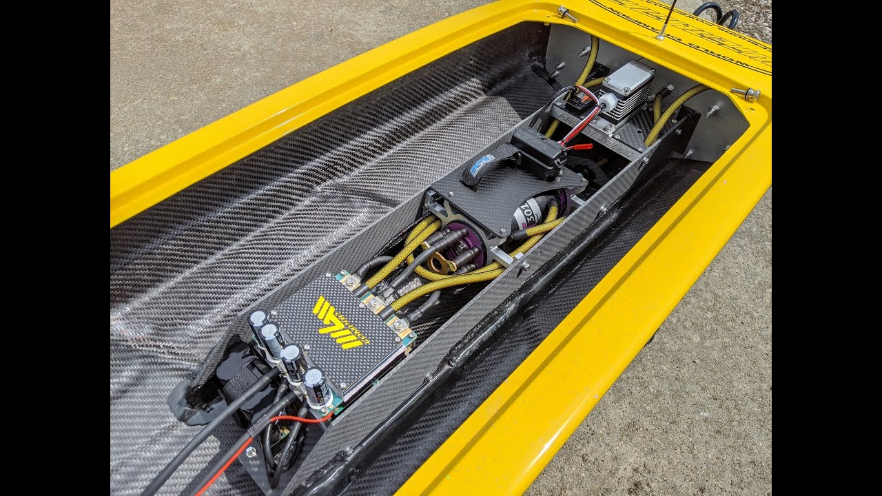

                    After the stuffing tube heat issues last fall during my maiden run, I decided to cut out my original 5/16" tube, and go with a larger one that uses a teflon liner. After getting this swap finished, I feel 100% better about it. There's better clearance between the flex shaft and the teflon liner than there was with the 5/16" tube, and less resistance when I spin it by hand. Wish I had gone this route in the first place. Live and learn though.
                    Also, as I try my best to promote new stuff and stay on the leading edge for my followers and customers, I am swapping up from the LMT 3080 (6 wind), to the newest addition in the Lehner line up, the 30100 (5 wind).

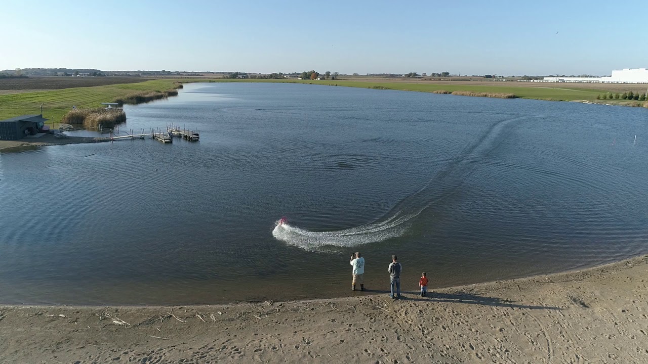

                                I do no know about my speed goal. I have not pushed the boat full throttle yet, as I need to get a few more sessions in on the water to get the battery placement figured out. As of now I've just had the packs stuck in the hull with velcro, as temporary mounting, to learn what placement is best for weight distribution before making permanent battery mounts. This being the case, I'm not comfortable going full speed with the boat in case it were to get out of control and knock the packs loose from their velcro.
                                Anyways, I got a little video the other day, after it's first time out on the water this year, with all the changes. As I said, no full throttle yet. (Pretty sure I need to move the packs forward a little)
