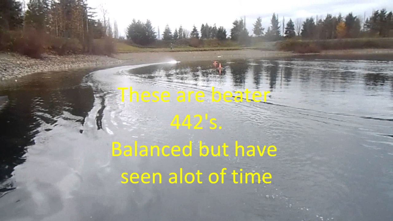

                  So an update is in order. I have it all together now, cooling lines and ESC's wires and installed
                    #39
                    At this point I decided to run it as this is.
                    I am real used to flat ride pad boats so this is a new game for me

                        #41
                        Nic. Couple things I noticed. Looks like it's pulling to the left? Could be a number of things and I'm sure you know what to check (flex dragging, throttle calibration, motor kv may be to far off). The main thing I noticed is your servo arm is waaaaaay too long. That's what will cause your erratic steering. It makes the rudder move too fast per servo input, and it kills the tq of your servo. Move the rod ends all the way inwards. I'd just get a shorter one honestly.
                          #42
                          Yeah that was an experiment. It's getting better thru adjustments.

                              I actually have the Flycolor 150's in there. Last run with 447's cut down to 42mm it pulled 114amps peak and settled down to 80. She was at 70mph and that was with my old 4s Revo's.
                                #45
                                Do change your steering geometry tho instead of crutching it with expo. It will be strong, more precise and be much easier on your servo.
