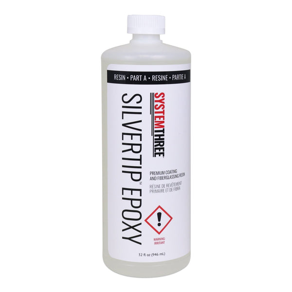

      I might have to try this stuff! Sounds too good to be true but if it's not, may be a better alternative to west systems
      SilverTip Epoxy is a medium-low viscosity, liquid epoxy resin system optimized for coating and reinforcing fabric saturation in wood-composite boat building.

              I have used system three for a while now though not the product you are showing. I have just a generial epoxy and one called Rot Fix which is real thin. I could send you a couple of small bottles if you wanted to try that. I think I have enough I would have to double check it.
                    http://www.systemthree.com/store/pc/...-Epoxy-c10.htm
                    That's it Travis.
