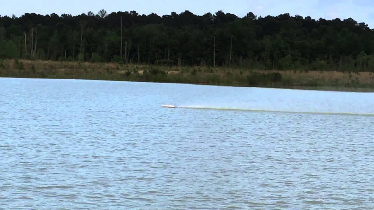

          For a delta Force, the Cyberstorm is a touch smaller, but everybody comments on it as being one of the best in the chop, I do own a Cyberstorm, but I haven't driven the others. If I build another smaller mono, though, it will likely be the KBB34.
          My private off road rc track
            Here's a video of it, I can't find one in chop tho. This is my sport setup. I tuned on it some and swapped props and it's a little faster now. Note: it would turn even better if the turn fins weren't so small.

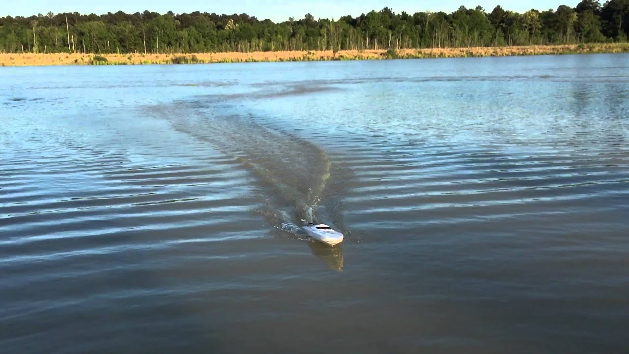

                    Here's my df 35 pirate.
                    Running 6s 1500kv

                      I'll be glad to help any of you guys get one together. I'd recommend doing one layer carbon inlay. It doesn't need it for the strength, but mainly for looks. Off white fiberglass gets dirty and nasty looking in a hurry, you can't do an inlay, I can do it for you. Now on to hardware...
                      A 4082 and t180 will push it fairly well. This hull is quite efficient. It's should do mid 60's with that setup.
                      Rudder: http://www.offshoreelectrics.com/pro...ckets+%26+More
                      Strut: You could do a stinger, which would be easier but does not have the adjustability so speed capability essentially goes down some. How much? Depends on how far off you mount the stinger. Make sure you get the round bottom one! http://www.offshoreelectrics.com/pro...=ros-spdss-001
                      I chose a flooded tube for my strut. I'm pretty sure I outlined it in my build.
                      I used the kintec adjustable motor mount.
                      Savox servo http://www.ebay.com/itm/Savox-SW-023...item5b05bd9485
                      .187 flex, mbp collet (highly recommend) http://www.offshoreelectrics.com/pro...?prod=mbp-1000
                      I used the xl battery trays, I chose to run them along side the motor for balance and lots of adjustment.
                      Trim tabs. http://www.offshoreelectrics.com/pro...prod=ose-80925
                      I used the smaller carbon turn find but larger ones would be much better if your looking to turn
                      Here mine is on 6s (it did go 68.2 when batts were fresh)
                      Whatever else you need let me know.
