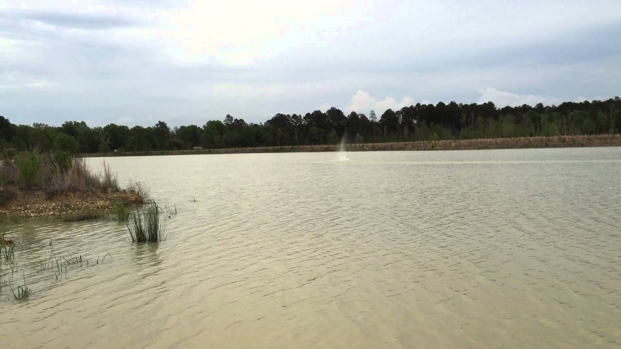

                Here's 6s (fell asleep waiting on them to upload)

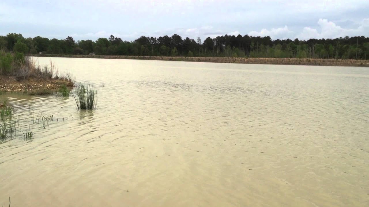

                  And here is 7s

                    Dam ! That's moving ! Time to put some turn fins on and practice turning and at least 3 minutes of it ! lol

                      That's awesome.................I actually liked the 6s run better though, nice sound and looked so stable.

                        7s run was looking great right at the end.
                        Then you let off the throttle?

                          Looks great Travis, It's got a ton left in it! That thing is gonna surprise you when you get it all dialed in

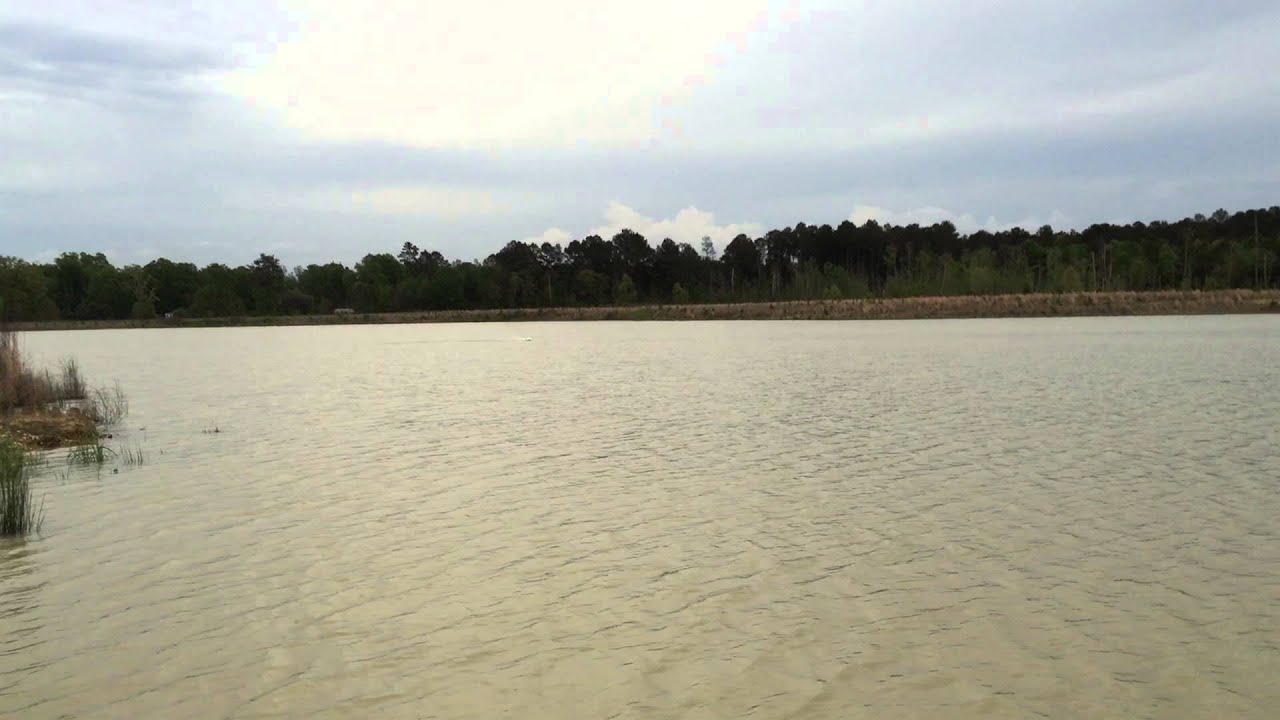

                            Thanks fellas! I'm wondering if the chine walking has something to do with having a 4s pack on one side and a 3s on the other. I'm going to make a weight stick to stick to the 3s battery to balance it out to see. I have a few ideas. I'll get past this hopefully. Here's another video, my very first 7s pass. I made several runs, didn't video every one.
