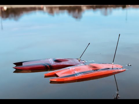

                        After all these years of collecting dust on the shelf it lives:
                        Twin Cats by Asa Eells
                        Here is it in the water. I think a little more work to it and it will be golden.

                          #327
                          Nice!!! looks like a lot of fun there.
                            #328
                            That thing is zooming. Great job

                              #329
                              Thanks, was a lot of fun. I think with some tweaking we can get some more speed out of it. I’ll need new escs tho. Are the mystery escs any better than from 10years ago? Or are they the same?
