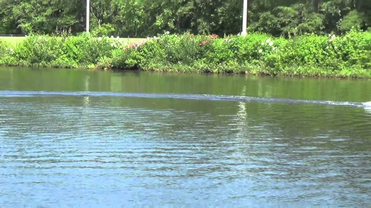

Have this on YouTube guys. Took forever to upload, just finished. Every video I do this to I loose quality, always looks fuzzy, damn. Watch it to the end.

Good maiden, congrats!
If I may say, try to make some full throttle passes, it did not sound like you had pull the throttle all the way most of the time, although I could be wrong. Part throttle runs like that is actually making the ESC work harder.
Can't wait to see runs with the deck in place.
Just so you know, quality isn't as bad as you think, this is standard You Tube. lol...Last edited by tlandauer; 08-11-2014, 01:58 AM.Too many boats, not enough time...

Your right tlandauer, I did not open her up much except near the end. Even that was not all the way.
My biggest issue is sucking air which makes it difficult to get the boat going. Look at 10:10 and 10:35-10:50, you can hear the slurping sound of the prop sucking air. At 10:35-10:50 you can see the column of air behind the boat, once the boat goes, that tube of air goes away. Also at 15:50.
I think with either prop it did OK, will have to try both again. Think the boat is trimmed OK? I might try moving the batteries forward a little.

Ken, That was Awsome, we all wish our maiden voyages went that well! Deffinetly prop up, I'd go something in the 52mm range next. Trim wise, I wouldn't change anything yet till you see how it runs WFO and then I'd probably just drop the insidetrim tabs very very slightly. It looked like the faster you went the smoother it got toward the end of the video. Also with 730kv you could go to 10s with no problem at all, I'm running 910kv and 950kv on 10s in my 1/8th Hydro and my Vern Kilmer Viper they are 44 1/2" and 49" boats. If you listen in the begining of this video it cavitates just a little with a Prather stainless 250 which is almost 59mm and 1.6 pitch https://www.youtube.com/watch?v=hCeYpy4NUyMLast edited by flraptor07; 08-11-2014, 09:08 PM.

Wow, fast, nice control you have! I have to get use to this speed, new to me. Your cavitation went away fast. Think I'll try again as is in another lake Wed or Thursday. Near the end I might have been getting some confidence. I don't have the tabs down at all yet. All for fun.

Also, when running the boat, I did not see much cooling water coming out, although the ESC was barely warm. In the video at 13:30 water is coming out of both ports. But don't see anything at slower speeds.
Sometimes it is only a dribble that will roll down the hull Ken. Try to get a good look at it or place a GoPro on facing the outlets. I had to do that once to check my 'hidden' outs.
Check the first of it.
