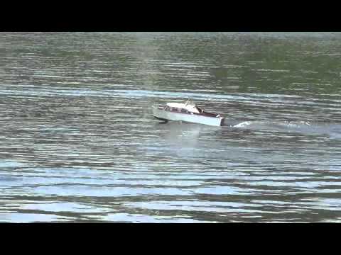

                            Exporting the video from iMovie now, then have to upload to YouTube so this may take a while. Sixteen minutes of video.
                            Have things that need to be worked out. Hopefully you guys can help me on that.
                            Overall I'm a happy camper!

                                #240
                                Thanks to you guys and this forum!
                                While the MacBook is doing it's thing, here are my observations, and you will see some of this in the video. Listing these line by line. I used clear plastic with electrical tape as a cockpit cover. Steve responded in email about the Program Box, have to read it and respond to him.
                                • When the boat starts out with either prop, there is a lot of cavitation. You can hear it sucking air and you can see the bubble behind the boat as it moves. I think as the boat gets going that bubble might go away, not sure. Boat is slow accelerating.
                                • At the far (left) end of the lake, there must be a dead radio spot. The boat stops coming out of the turn. My radio is on 75Mhz. Someone else's 2.4 also stopped sometimes.
                                • At the close (right) end of the lake, same thing sometimes, but not all the time. Boat seems hard to get moving at this end at times.
                                • First run I did not have the transmitter rudder adjustment giving me full throw so the boat was not turning well. Adjusted that for the second run, better.
                                • All cell's started out at 4.2 volts, after almost 25-30 minutes of running, cells ended up at 3.86 volts (end of the day all done).
                                • Only saw cooling water coming out on high speed passes, nothing at all at moderate or slow speeds.
                                • Swordfish temperature after getting the boat out of the water and on the table was about 115˚F. Used a temp gun.
                                • Motor was slightly warm to the touch. Batteries and wires not even warm.
                                • Boat trim looks good in the video, maybe move the batteries forward some? You tell me.
                                BTW, it looks faster in person then the video. I never opened the throttle all the way. Near the end of the video there are a few shots where I almost opened it up.
