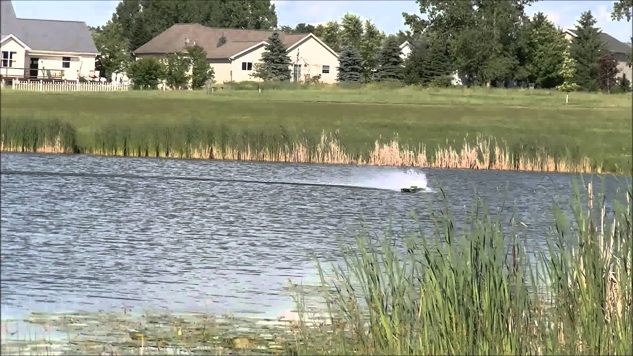

                    Maiden run with x457s. Good for 80mph but ultimately the 3/16" shafts I'm running here are too small. I have some 1/4" shaft drives/props for it but they put me around ~100mph so I'll probably order some 1/4" propshop props for "sport" runs. I was happy with the performance. When you carry this boat it's hard to believe that a couple electric motors can move it like this. It's definitely a LOT of kinetic energy!

                      Nice

                        Looks great bro

                              Nice run Keith
