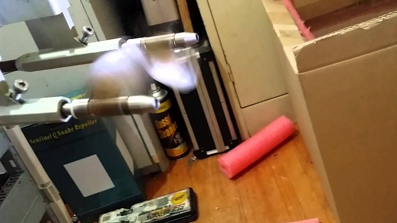

                      20140402_211938_resized.jpg 20140402_211954_resized.jpg 20140316_181455_resized.jpg
                      Mwahhahaha,, MWAHAHAHAHAAAAA
                      it's alive !
                      Presenting a major break through for unintentional Duck processing.
                      Be afraid, be very afraid !
                      ( I sure was .. power drill in one hand., camera in other
                      Noise is mostly the drill itself ... )
                      I later fired her up on 12S1P(50VDC) with Castle2028(780Kv) and SF300 esc,,, sounded like an angry bandsaw at 40k rpm !!!!
                      WOOHOO !!

                            Shawn.
                            The oil fillers were an after thought ! ..
                            Was planning for inboard oil cups.. but the space is more limited in the rear than expected..
                            however Im impressed the bling factor
                            John.
                            The W drive is sourced from http://hyperprod.bizhosting.com/index.html
                            Be patient.. work is great but dispatch speed not so ~$250USD
                            This has been 5+ months in design and various build stages...
                            The gearbox needed some work to spin free unloaded..
                            The distance between outputs is 50mm... between output shaft centers at prop is 70mm.. and those S bends for brass output shafts was a long term work of art to release the flex under load....
                            Have no idea for on water performance .. but I have a smile at the ready ......
                            Already run one of these hulls as a single with the very same motor/esc/cells.... easy 75mph
                            ...... wont know how this one goes until it does :grin:
